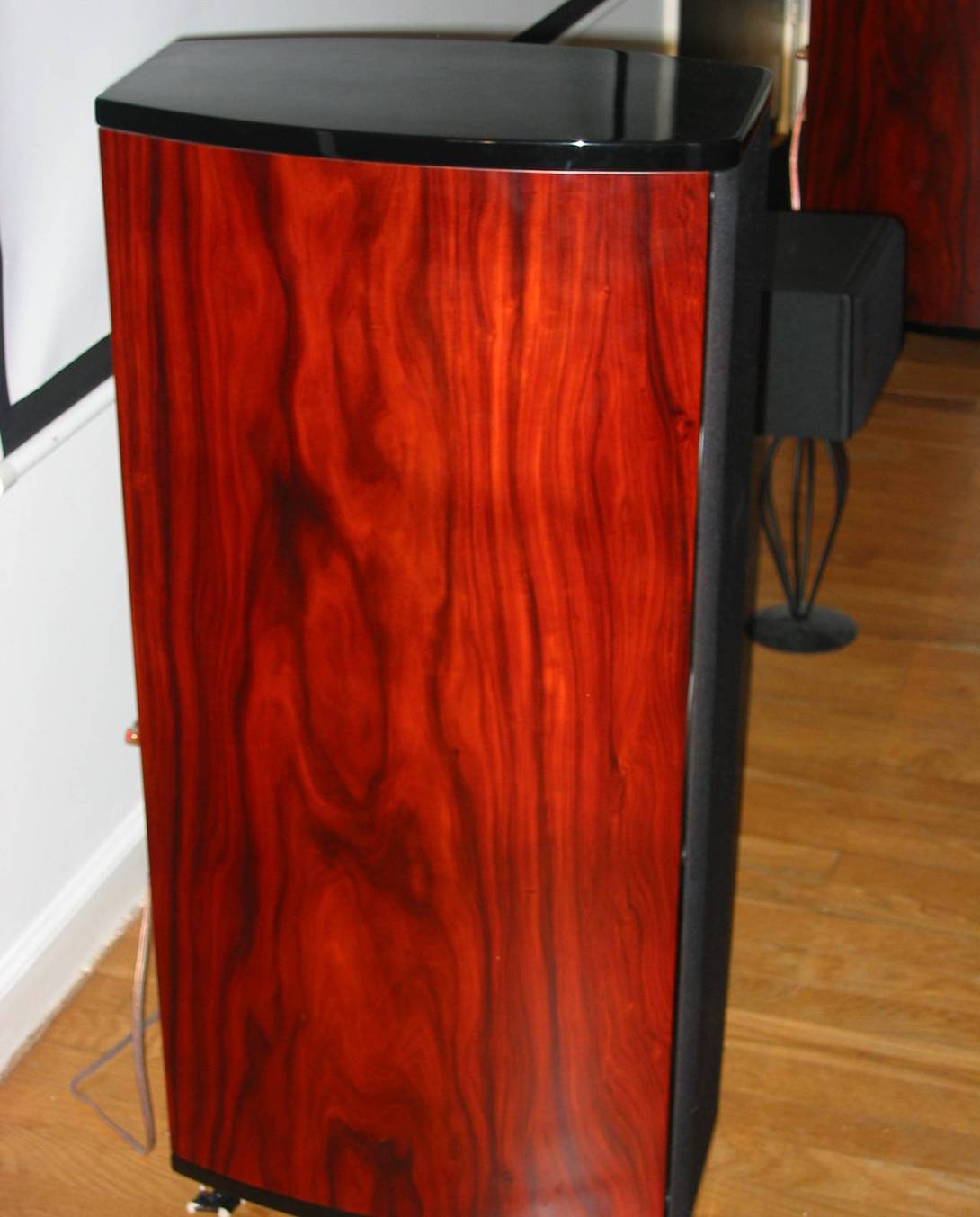

Instead of trying to hide the speakers, why not make them the focal point of the room? How about speakers that look like beautiful pieces of funiture like Rockets by Onix www.av123.com or some cool artful creations from anthony gallo at http://www.roundsound.com.
I love my rockets:cool: and everyone that steps into my room gasps and states "THOSE ARE GORGEOUS!!"
