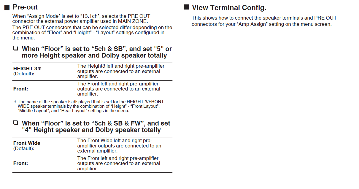

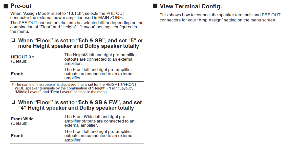

You don't need to wait for Marantz, the SR8015's amp assign feature works the same way as the SR6015, and AVR-X6700H, you can only assign the front L and R to pre out, aside from the default settings that depends on your floor and height layouts selected.
It is on page 250 or the owner's manual:

Some very good points. I have looked at that part of the SR8015 manual and you're correct. Other than more configuration options than my SR6015 has, it has the same assignable pre out options and the X6700H appears to be the same.
