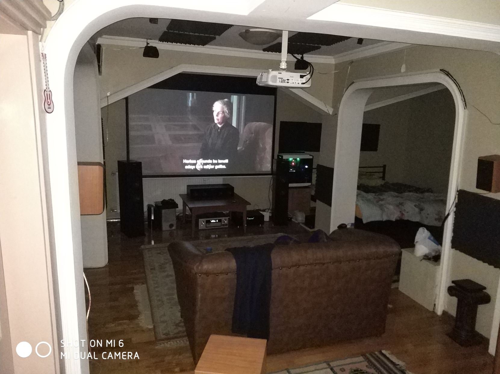

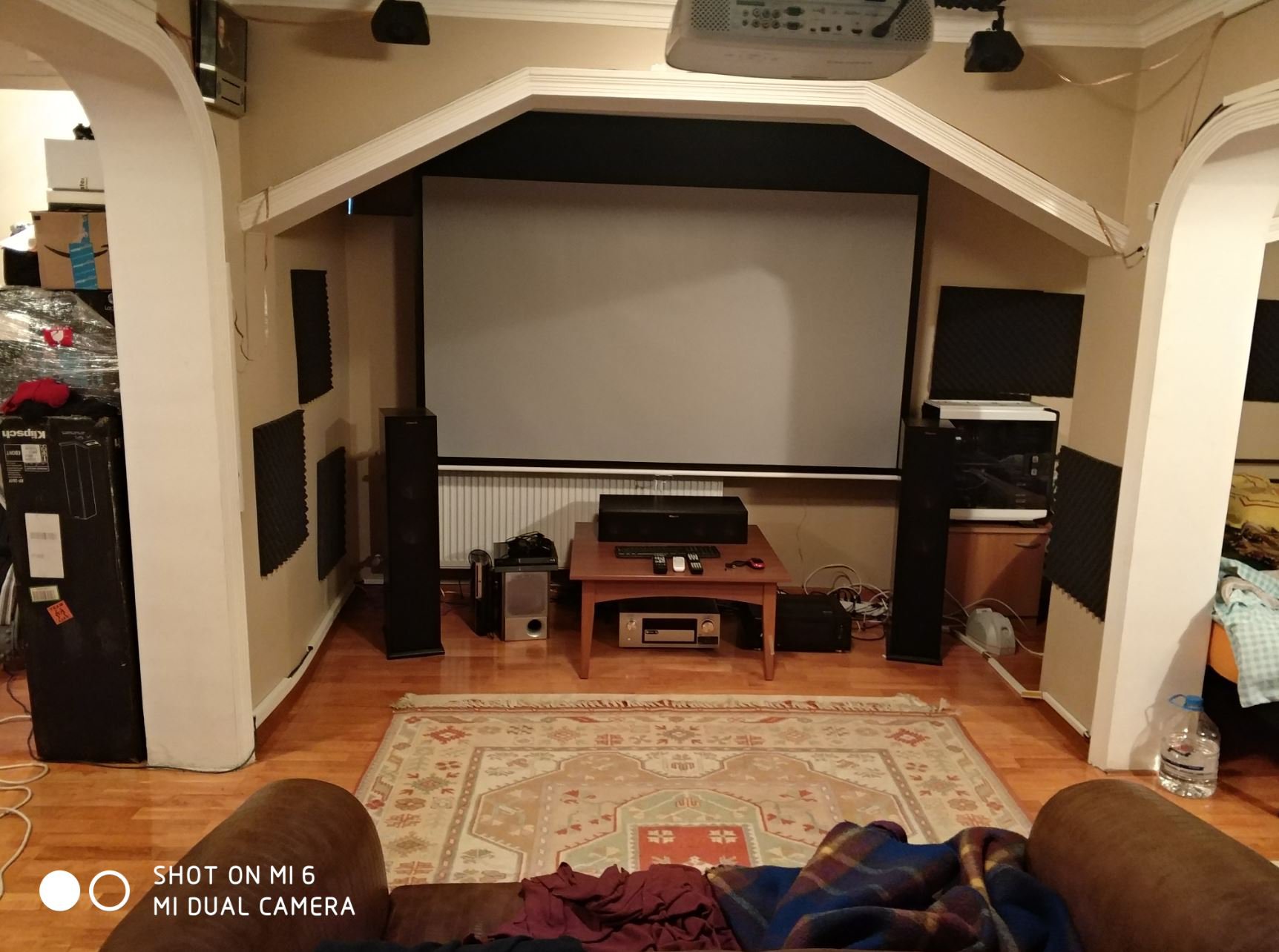

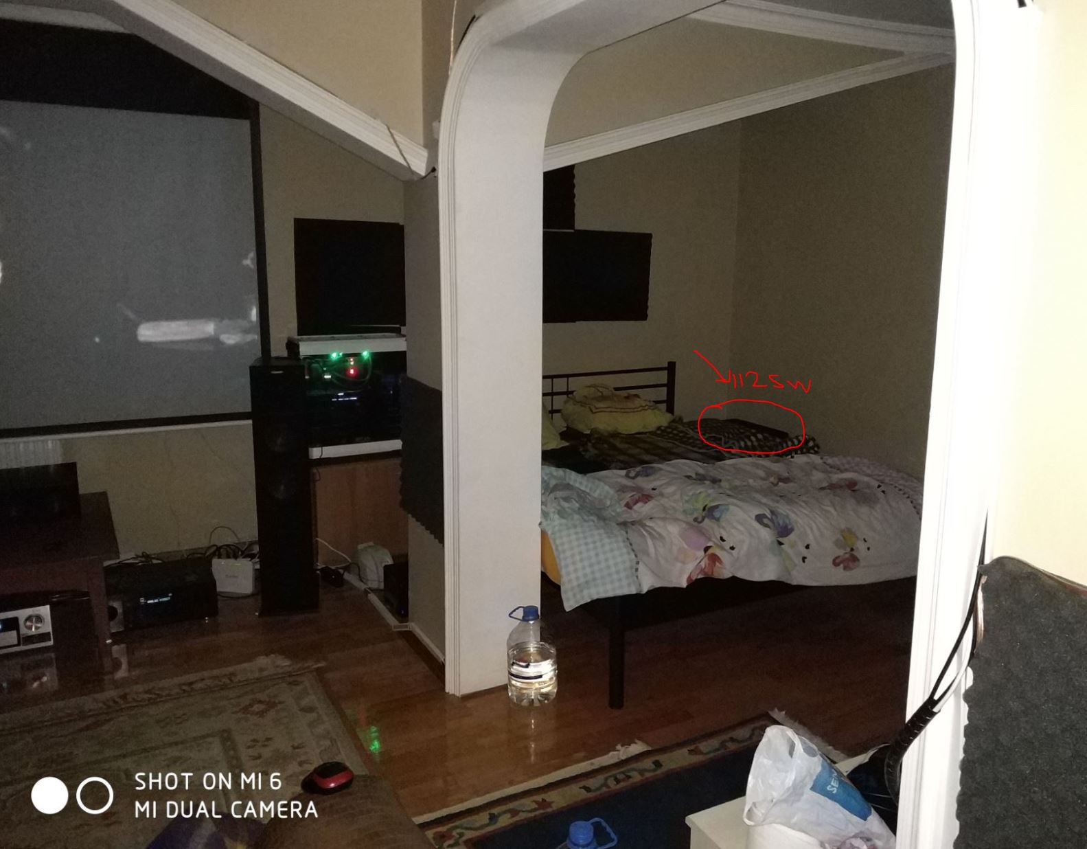

SpiritRises
my current room size is 40m² and i could not maintain the acoustic.There is no carpet in the room and it does not have any shape.The main listening area is rectangle but the right and left side don't have any walls and opens to another rooms which are 3 or 4m².And the back of the main listening area is wide open.You can imagine that i am sitting in a place that covered with 3 little rooms and 1 kitchen with no walls or doors seperating those roooms or kitchen or main listening area.And there is no carpet on the ground.
So i could not maintain the acoustic and probably will not be able to.So i am moving to 20-21m² room that can be esignable much more easier.And my main listening area i mean the sofa will be maximum 2-2.5 meters away from the screen.And i will my rear surrounds most probably 1.5meters away.
For a 40m² or more sized rooms should i need a power amp?
and for 20-25m² sized room i will not need an amp right?
i mainly use my system for movies by the way.
Denon states 125watt for each channel for the Denon X4400H but i do not think that can feed that much power on a channel.What can be the real power of the channels when the all channels get drive?

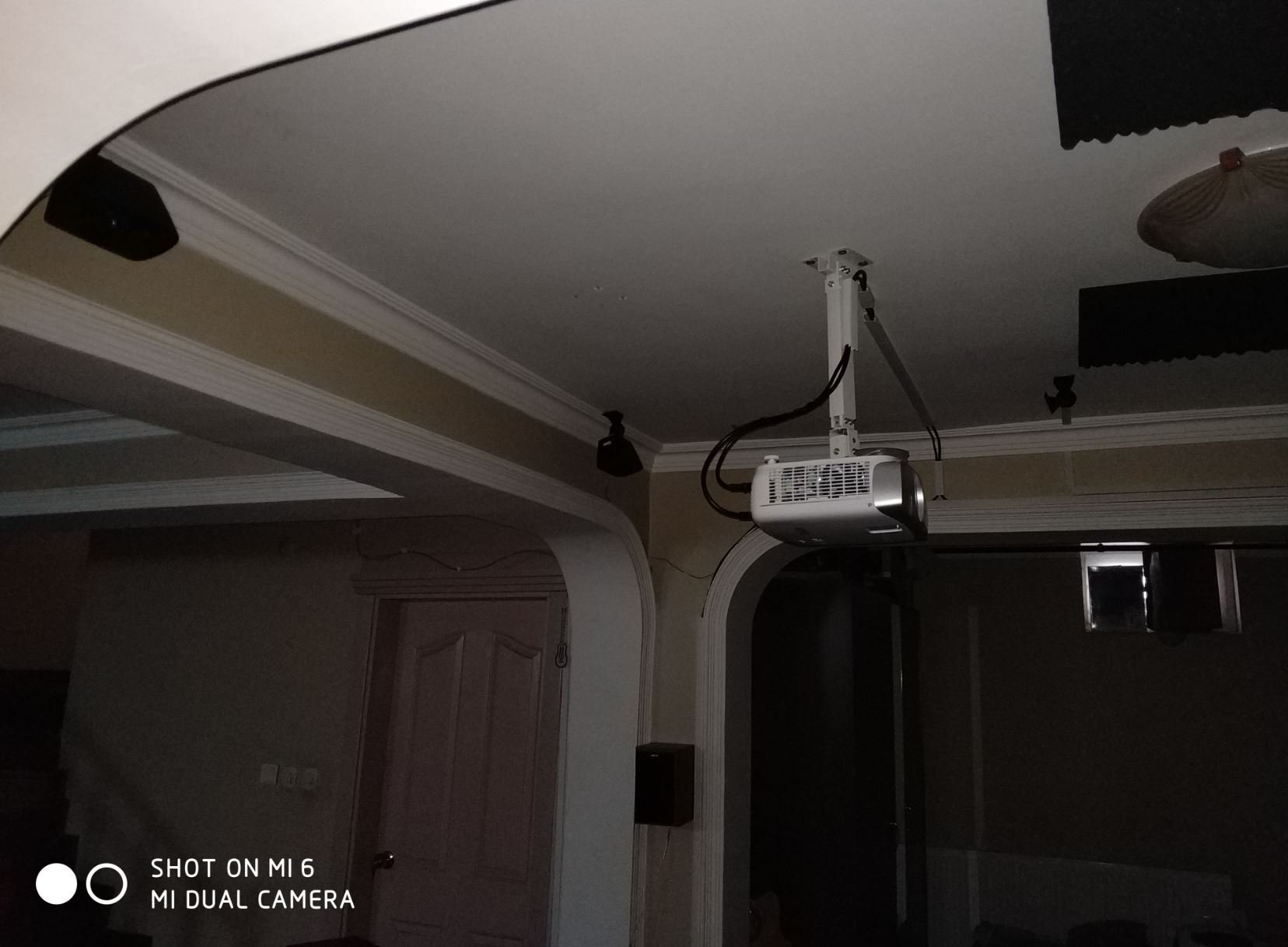

I also use 7.2.4 Atmos setup.I achived that via my old Pioneer VSX-921K AV receiver in order to drive 2 atmos channels.Denon only supports 9.2 and i could able to add 2 channels more via Pioneer VSX 921K.
And i am using Logitech Z906 speakers for as my ceiling atmos speakers:)
is it a right thing that i am using z906 speakers as atmos speakers? if i change them with the Klipsch ceiling 3800 or 5800 series , will there be any significant difference?

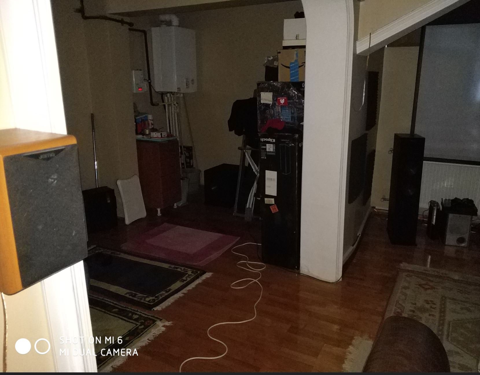

EDIT: i could find the pictures i have taken before.The subwoofers are located in all the way the right and left corner of the whole area.So for the area in the pictures, should i get a power amp?
View attachment 29113View attachment 29114View attachment 29115View attachment 29116View attachment 29117

Hey sorry I'm late getting back works been crazy
Ok so that's my place just setup like yours is crazy crazy lots of walls and arches and open open space with no real place to setup surrounds can't wall mount them stands are just begging to get knocked over
Open big big space not sitting close lots of air to move in that room
lots of difficult reflections etc etc
So how I resolved my issues is 1 I went to all towers in my 7 bed layer surrounds
In picture 3 you see where I moved the SVS prime towers to surrounds and have the Klipsch towers upfront In picture 1 you see where I had the prime towers placed at just the right height on special stands I made
Using towers just improved dynamics helped move air and really helped out on when I wanted to get a good setup for listening to lower volumes
Using Klipsch really helped with directivity they have good controlled dispersion which helps with avoiding reflection problems that can come into factor in that room.
Wanting to use all towers and wanting to move some serious air not just loud but also for lower playback I found amps were necessary for me in a room that size.
They don't improve the sounds a good amp is neutral to the source but they allow you to hit good volume clean with great dynamics in big spaces like that
To help with the acoustical issues you have in that room making sure you have the right speakers using room correction room treatments and proper speaker setup in all positions should do a lot to help with your acoustical issues
The amps will just help to hit good volume level in that room size with clean no distortion neutral playback of the source. But power won't fix acoustical issues it may even make them easier to hear you can't power your way out of them
You have to utilize room treatments proper speaker layout and a good room correction program to help that
After that you use those amps to jam those speakers to any level you want!
