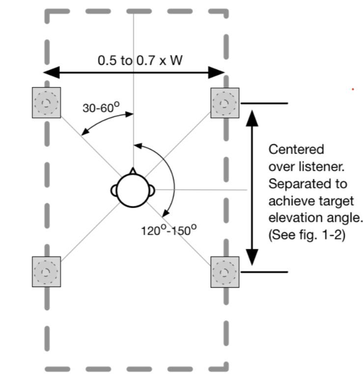

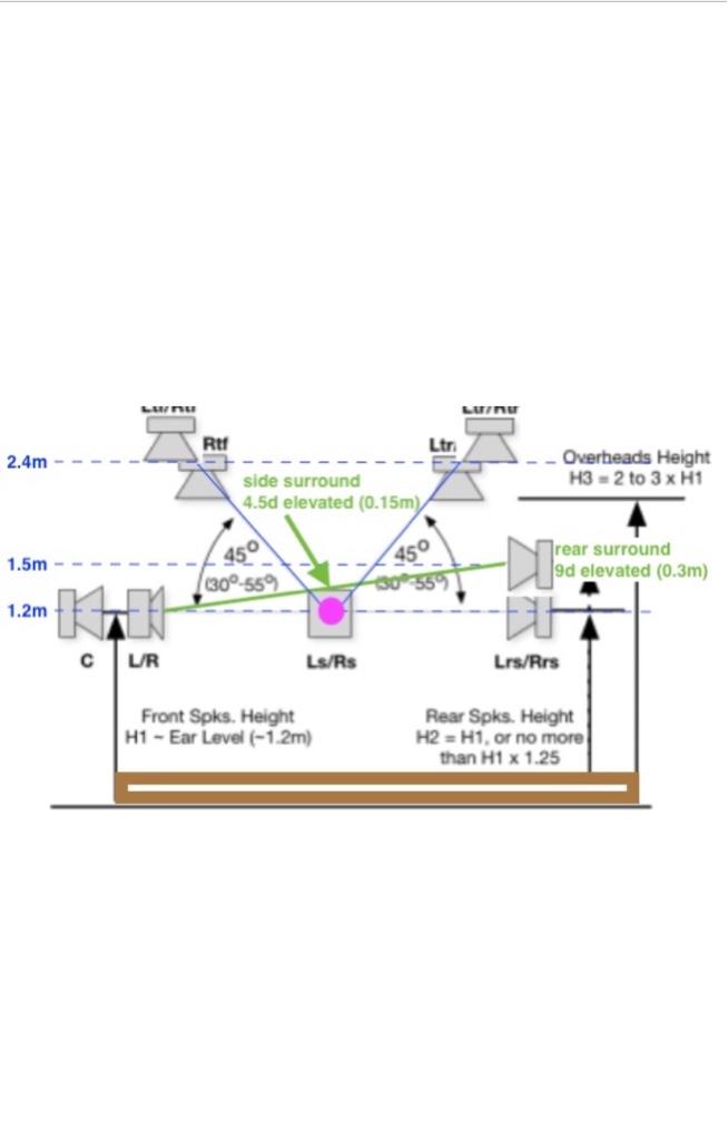

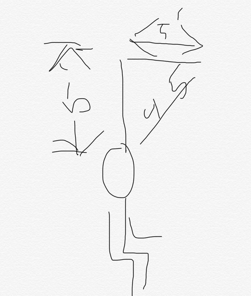

Well I agree with Jim in that there a couple flaws here. For your top speaker placement it should look like this.
And the goal is 45° fore and aft. So measure from seated ear height, and that’s how far in front and back you should place them.
It also looks like the surround, and rear surrounds are intended to be in the ceiling? If that’s the case, then I would skip Atmos altogether. It needs the height differential to work.
