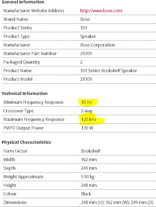

Hi whats the best crossover setting to set for my speakers and sub
massey148
I have a Denon amp, bose 301, center 110 bose , rears is bose and a 10" klypse sub , trying to find out the best settings for speakers

Between 80 and 110 should be good, see which sounds better to you

Should have mentioned to set all speakers to small after running audyessy if it didn’t set them that way
I'd probably set the bose surrounds with an even higher xover if they are the little sats. 80-110 for the fronts sounds about right range to try. Hopefully not too much localization of the sub.
