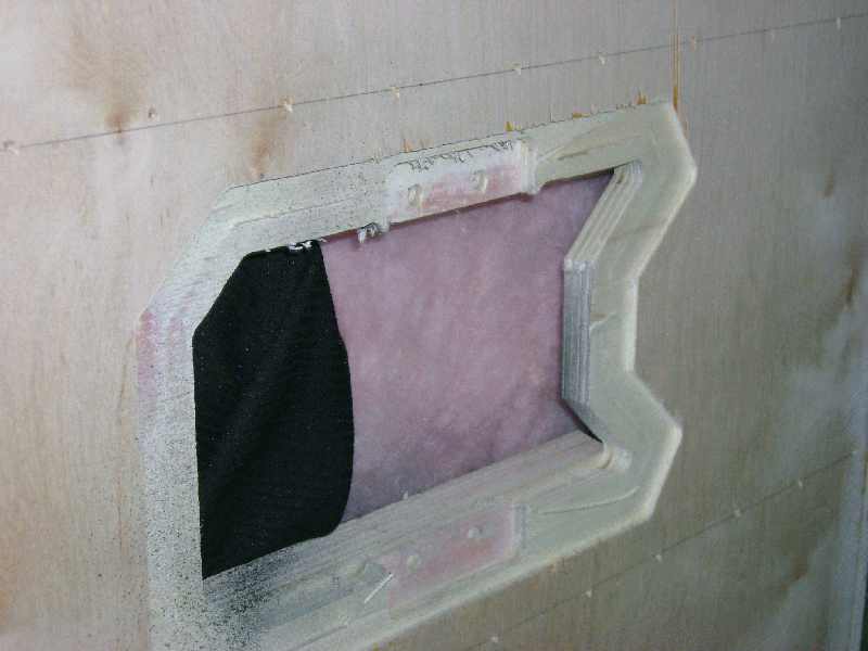

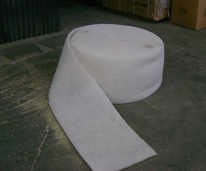

Fiberglass Insulation (left pic) ; Polyester roll (right pic)
Back in the day when the USA still had a significant manufacturing sector in the audio industry, we routinely used fiberglass to accomplish these goals. The problem with fiberglass, and the primary reason it was replaced with polyester fibers, is that it is created from short straight glass fibers (normally held together with a glue) which come free from the material and stick in your skin providing a great deal of irritation when it is handled. The loudspeaker industry’s collective solution to this was to switch to polyester fiberfill, the same material used in perhaps as many as 90% of all those hypo-allergenic pillows you find in the department store. This was a great relief to those who had to stuff boxes, and a great irritation to the few of us who actually performed side by side comparisons with real fiberglass. Having measured different varieties of polyester fiberfill (including hollow fill) and comparing it to fiberglass, the results of using most fiberfill are much closer to using nothing than they are to using fiberglass or higher density sound fill. (Yes, long haired wool is still the best, and at last check it still cost about $13 per pound.) Ironically, Owens Corning solved the problem of fiberglass irritation by creating a product some years ago where the fibers were curled, which stopped them from irritating exposed skin. Sadly, because it was slightly more expensive than the straight fiber fiberglass, despite the fact it was non-irritating to the skin, the company ceased production of this material. It is a good bet, the cheapest and fastest and most dramatic fix a consumer can make on his system would involve replacing polyester fiberfill with real fiberglass in his cabinet. To keep it in place, a slightly porous cloth (we use grille cloth) can be stapled on top of the fiberglass to prevent the escape of the material through the ports, or its entry into the internal moving parts of the loudspeaker drive units. The grille cloth is acoustically transparent so its presence does little to stop the wave from being absorbed (in part or whole) by the fiberglass.
