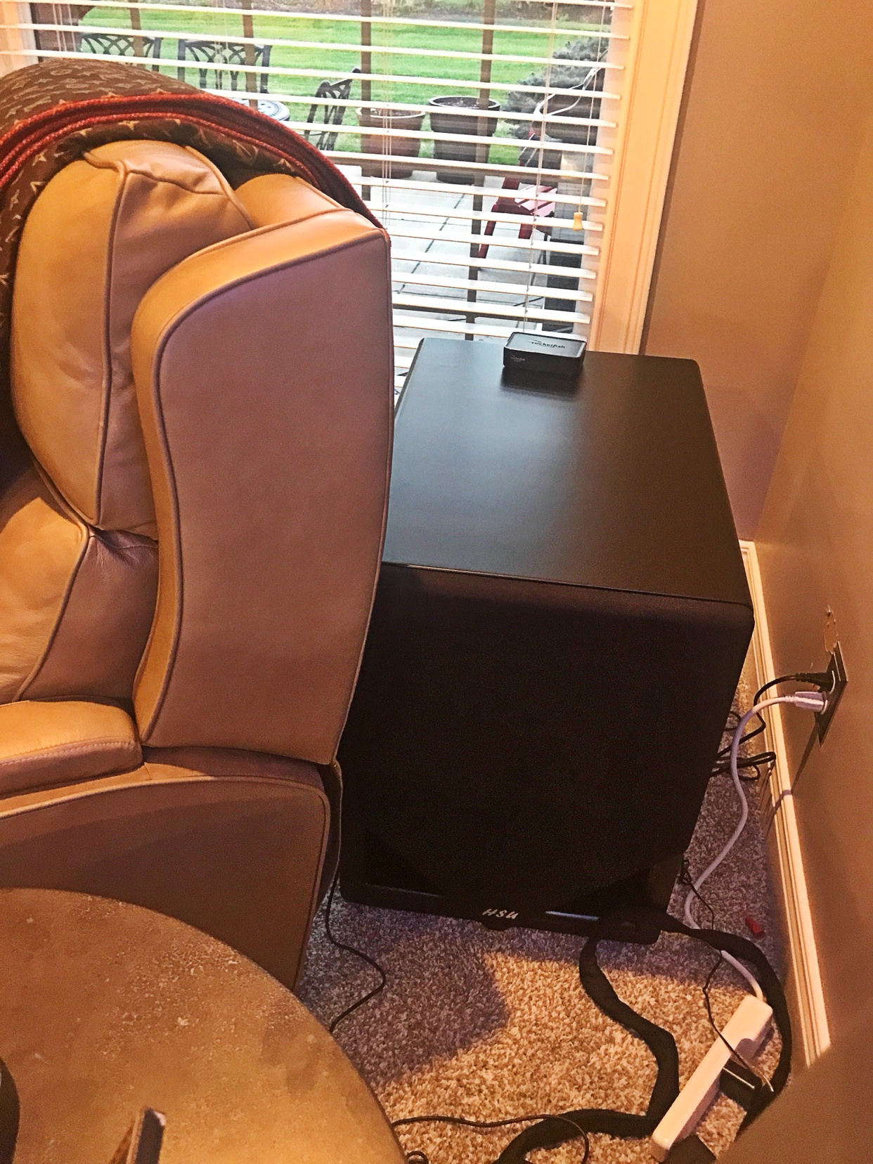

I went with one and I’m in aww of what a true subwoofer is
Looking at The size on paper is different than actually setting it in the room ..
I’m actually fixing to change out all my components from speakers to Equipment except sub..
I kinda caught the bug and after hearing the Focal Aria 936’s I was blown away
Do I spy a rocketfish wireless sub adapter?
