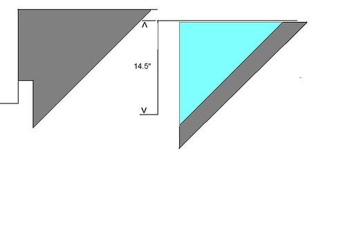

I did up a dawing of what I see as my 3 options.
1. full corner trap with an area notched out to fit around the top of the curtain.
2. 4" (or 6...) diagonal
3. full corner trap moved forward (grey+blue area)
Given where this is going, weight and how easy it is to handle is a factor as well.
I havn't chosen curtains yet so I don't know exactly how much clearance I need.

i would go with the solid corner trap with a notch. i wouldn't think it was only 5-10% or even 15-20% more effective. I'd say at least twice as effective - wild guess on my part, but if you look at the total volume of fiberglass, I'd say it's more than double the 4-6" panel trap.
the corner trap moved forward would be my second choice.

4" is a minimum for decent bass absorbtion - gap or not.
What you can do to make your life easier is to just do 4" on the angled face and then stuff with standard fluffy insulation behind. That'll work very well and save you a lot of work and some cash.

So, solid is much better than 4" diagonal.
I looked at the space again and, from an astetics point of view this is going to be a challenge.
The back wall with the balcony door extends into the dining area (19' total), but I was only planning on extending the trap across the 11' livingroom area.The balcony door covers 6' of that livingroom area.
So:
1. For best effect I need a solid trap.
2. I need to find an estetically pleasing way to end the trap at the dining area.
3. I need a simple way to make a gap for the curtain across the balcony door.
I suspect notching is the simplest way to go for the gap, even if it will be time consuming. I 'only' need to notch 38 tiles.
I also need some sort of light weight frame to attach cloth to that needs to conform to the shape of the trap.
My walls and ceiling are an eggshell white so I will find a cloth that matches that as closely as possible.
Thanks everyone for your help so far.
