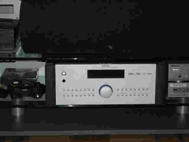

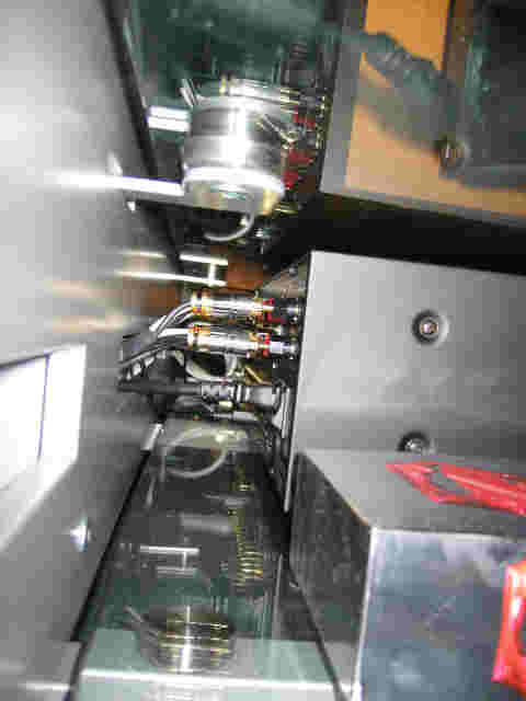

I just got a new Rotel RSX-1056 and installed it. But I only have about 0.25 inches of space above it (though theres plenty of open room to the side). Is that ok or do I need to add any additional cooling? Any suggestions?

If you do not have a few inches above it the 1056 will get very hot.At the very least it will shorten the life of the 1056.

Thanks guys! The Cooling Plate solution seems to be mostly for cabinets but mine is in a shelf with only about 3 inches space behind.
As for getting a computer fan thats probably what I am going to do. But the problem is that there is hardly any place for me to mount the fan at the back as well. So I think I am going to have to make a channel that will draw air from above the receiver and send it out the back thru the fan.

Maybe the pics will help
Pics of the front and back of the receiver. Should give a good idea of how much space I have around it.
