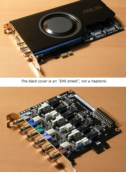

This should explain all:
There is a bus connector on both cards that is tied together via a ribbon cable.
That's a beautiful piece of equipment. With Asus reputation I imagine it's solid.
