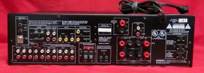

Back of the receiver - hard to tell, but Subwoofer L/R outputs are towards the top, to the right of the upper binding posts.
