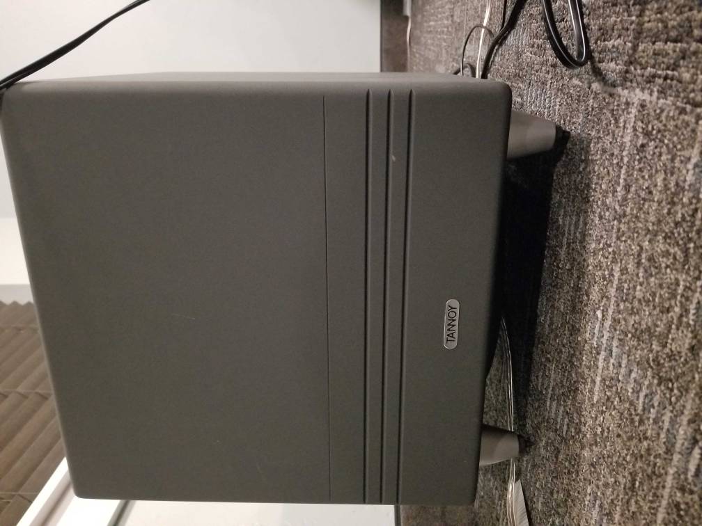

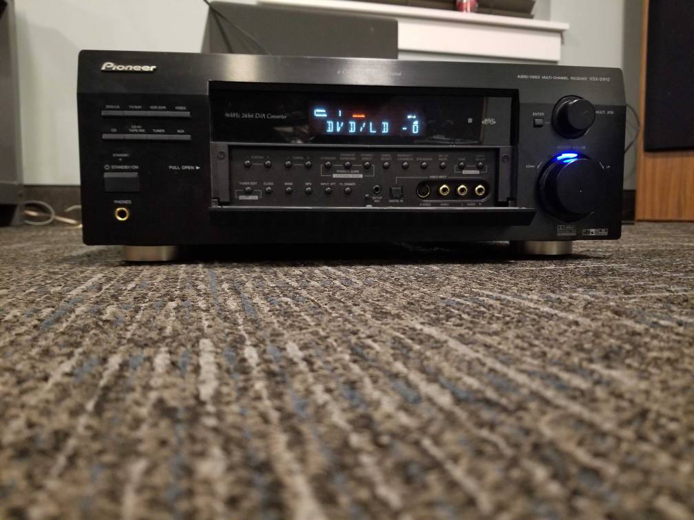

Hi all, I have a Pioneer VSX-D912 receiver with an rca input from my tcl Roku tv. The speakers are working great but I just got a Tannoy TS12 sub connected to the "Sub W. Preout" from the reciever. The only way I can get anything out of the Sub is with the receiver cranked all the way up, and even then it's minimal and unpractical to have the speakers that loud and the sub so soft. I have adjusted all the knobs on the back of the Sub with no success. Anyone know what I am doing wrong? A setting I need to change or different input/output methods?
Thanks for any help!
Sent from my SM-G955U1 using Tapatalk
Did you re-run MCACC? Does the volume of the sub change when you turn the gain up on the sub (might be labeled volume)? You have speakers set to small?
