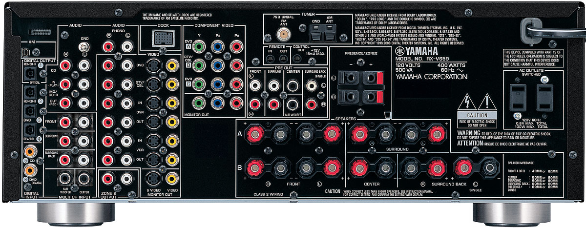

I want to be able to hook up my AppleTV (3rd Gen) to an older HDTV. Let me explain my set-up so you know my limitations. It's a Mitsubishi Proj TV Diamond Deries (2004 maybe?), and it does support 1080p. However it is built into the wall and I only have access to a cabinet that holds the Directv DVR, a VHS player, a DVD player, and a Yamaha RX-V659 receiver. Therefore, I can only hook up the AppleTV by going through another receiver. What's my best option? Here is my thinking.

As stated before, I can't access the TV directly. I only have access to these receivers. Everything goes through the Yamaha receiver, including the DirecTV HD DVR. My hypothesis is that I can use one of the Component inputs to get the AppleTV into the TV with an HD signal. Then I could use a Toslink cable to transfer the audio. Here is what the back of the receiver looks like:

Thank you. I believe it's only connected by component. Perhaps the monitor out output.
