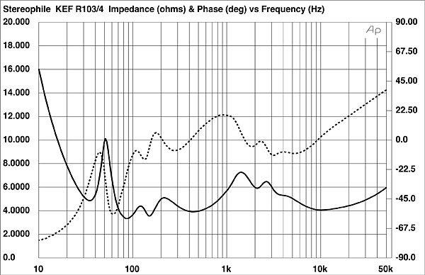

He would have to play it very softly indeed. Those speakers are known amp busters and need beefy amplification.
Here is the impedance curve.
The impedance dips below 4 ohms. It is pretty much four ohm from 60 to 600 Hz which is the major power band. Worse the phase angle is in very negative territory where the impedance is low. So the amp will see a lower impedance than measured below 100 Hz until the tuning peak.
I would not recommend driving those speakers with that receiver.

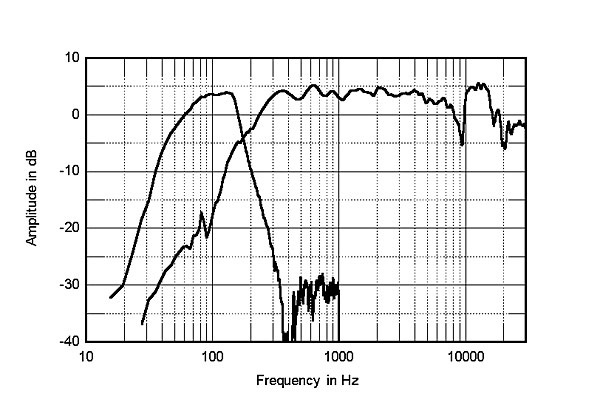

The KEFs have another issue, which I suspect is shared with both the speakers referenced.
If you look at the frequency plot you will see a deep notch out in the 9 KHz region.
I have form with this issue also. My current studio center uses the SEAS prestige coaxial drivers. SEAS make these drivers under license from KEF and there have a lot of similarities with the early KEF Uni Q drivers. They have that very same suck out in the 9 KHz region. This is subtly audible and imparts a dullness to the HF. I am certain that this problem is due to cancellation from cone reflections from the tweeter. I found this a very difficult problem to deal with.
However dealt with it was.
So in summary if you are going to use that Onkyo receiver, then use the Q90s. They are likely the better speaker anyway all round.
Both of them are pretty good speakers, although the bass bloat of the 103/3 will likely present problems in a lot of rooms.
I can find no third party measurements of the Q90s, but I would expect them to have the same HF suck out. In any event a dip in frequency response is far less noticeable than a peak.
