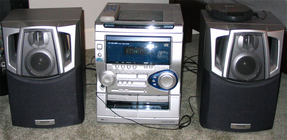

I also have this sitting around doing nothing since I only listen to music on my computer (Aiwa cx-naj20) (and yes, I have to use my discman with the car adapter because the cd changer doesn't work...:eek: ):

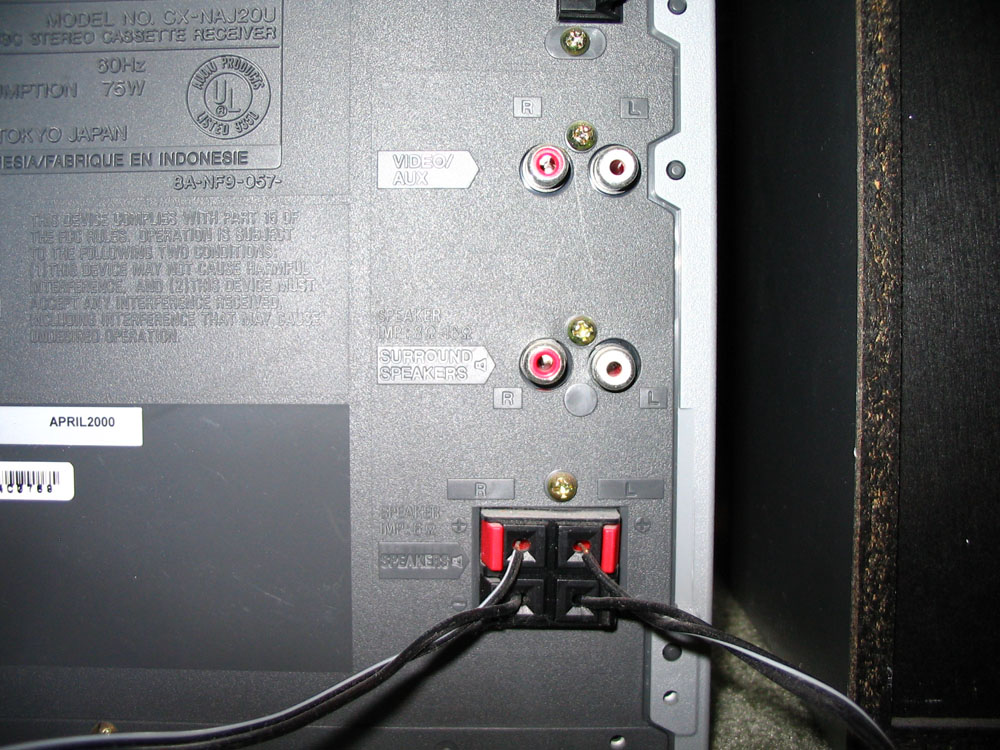

Here's the back:
I know that the Aiwa speakers can't be connected to my Creative setup, but is there any way to connect them to my sound card? Is there an adapter, or do I need an extra amp for the Aiwa speakers?

You should be able to connect the line level outputs on your sound card to the video/aux inputs on the stereo. RatShack (and others) sell inexpensive cables to do this. They have a 1/8" stereo mini plug on one end and two RCA plugs on the other.
U
Unregistered
Guest
sweet, thanks. I didn't know those were inputs... works great.
