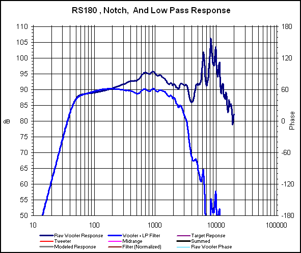

Break-up is when a speaker cone no longer operates like piston, but instead moves back & forth in different places on the cone's surface. The picture on the left shows a Kevlar woofer breaking up at 3500 Hz, and on the right a different woofer (metal alloy?) doing alright at 3500 Hz.
Swerd
Swerd
I found a few more figures showing break-up. First is a Dayton aluminum 18 cm (7") woofer. Dark blue is the raw unfiltered frequency response, and the light blue shows how a well-designed low pass filter suppresses the break-up noise.
Here are cartoons of break-up in motion
And proper pistonic motion
