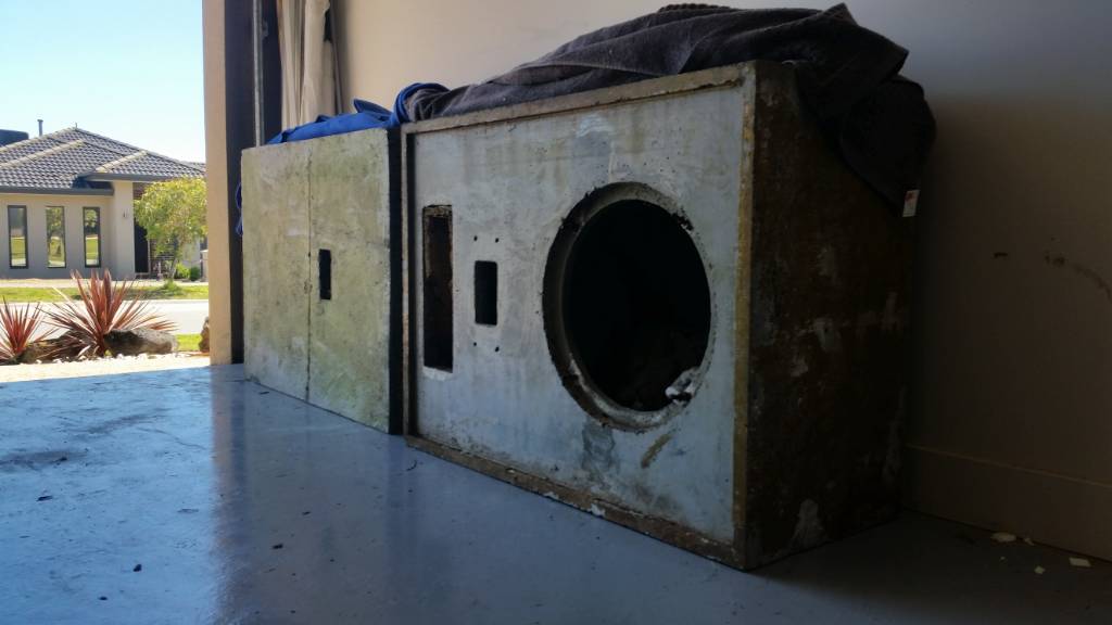

Here is the picture of concrete enclosures I have. They are made for Tannoy HPD385 drivers.
Sent from my SM-G950F using Tapatalk
