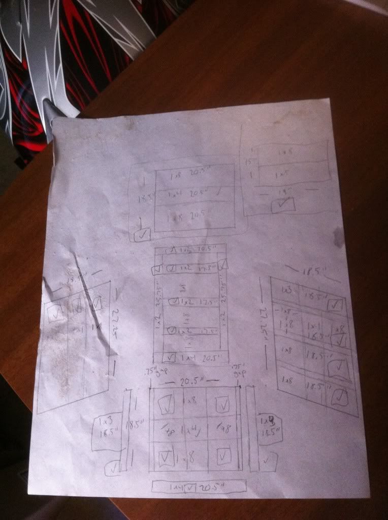

Here's my hand sketch of what I'm building:

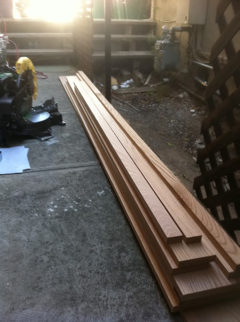

My VERY tight working quarters. Since I no longer have a garage, I have to work in the open. And I have very nice neighbors whom I do not wish to upset by coating their cars (especially the old Porsche 356) in saw dust. So I work in my alley.

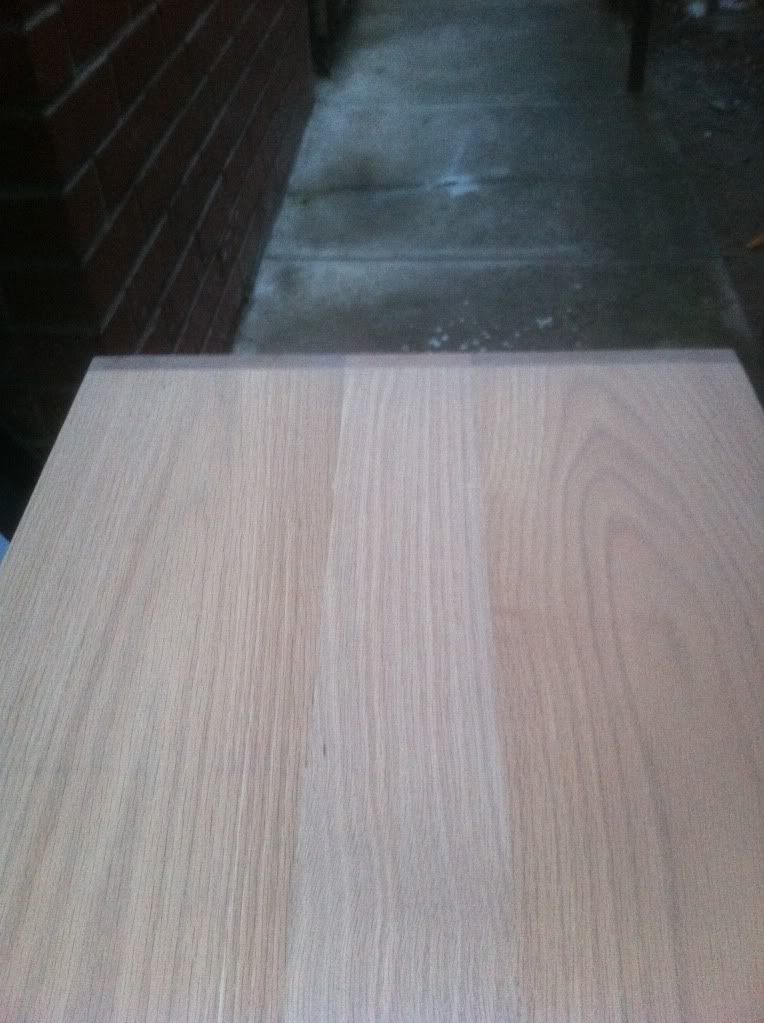

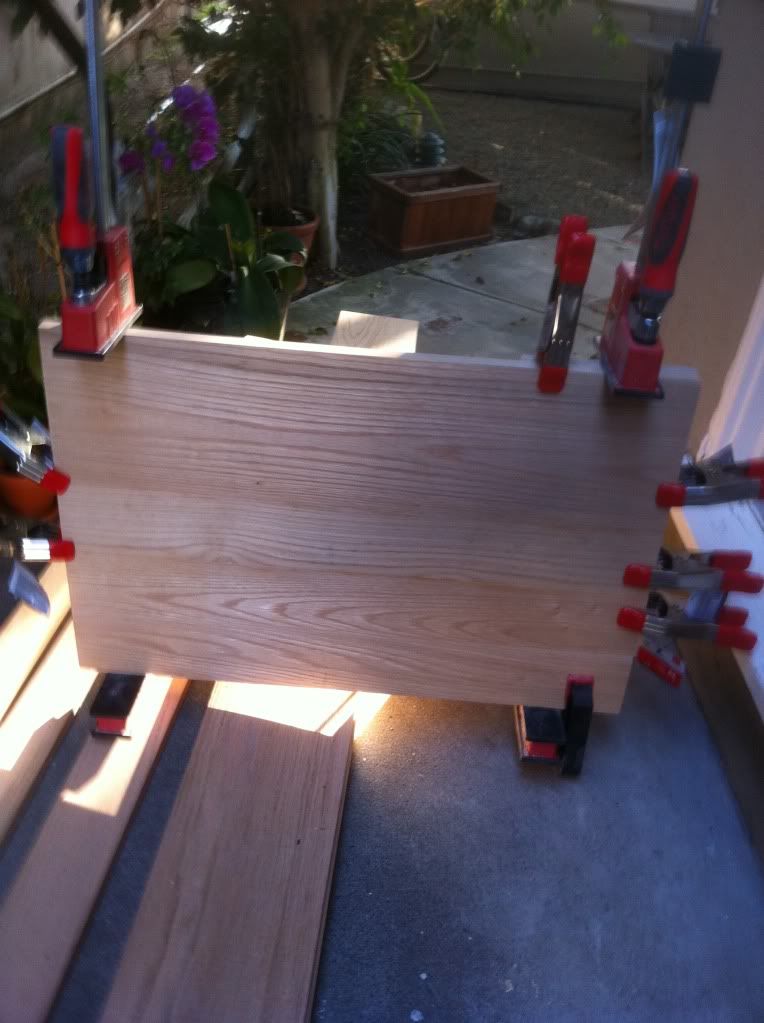

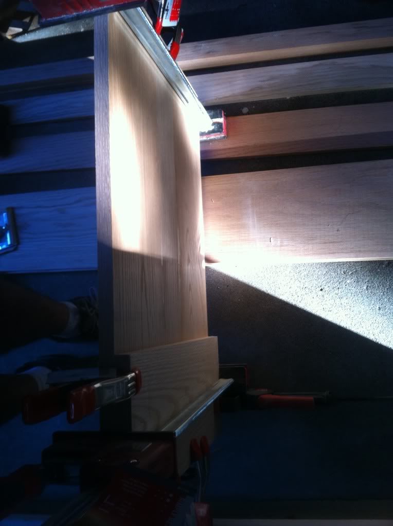

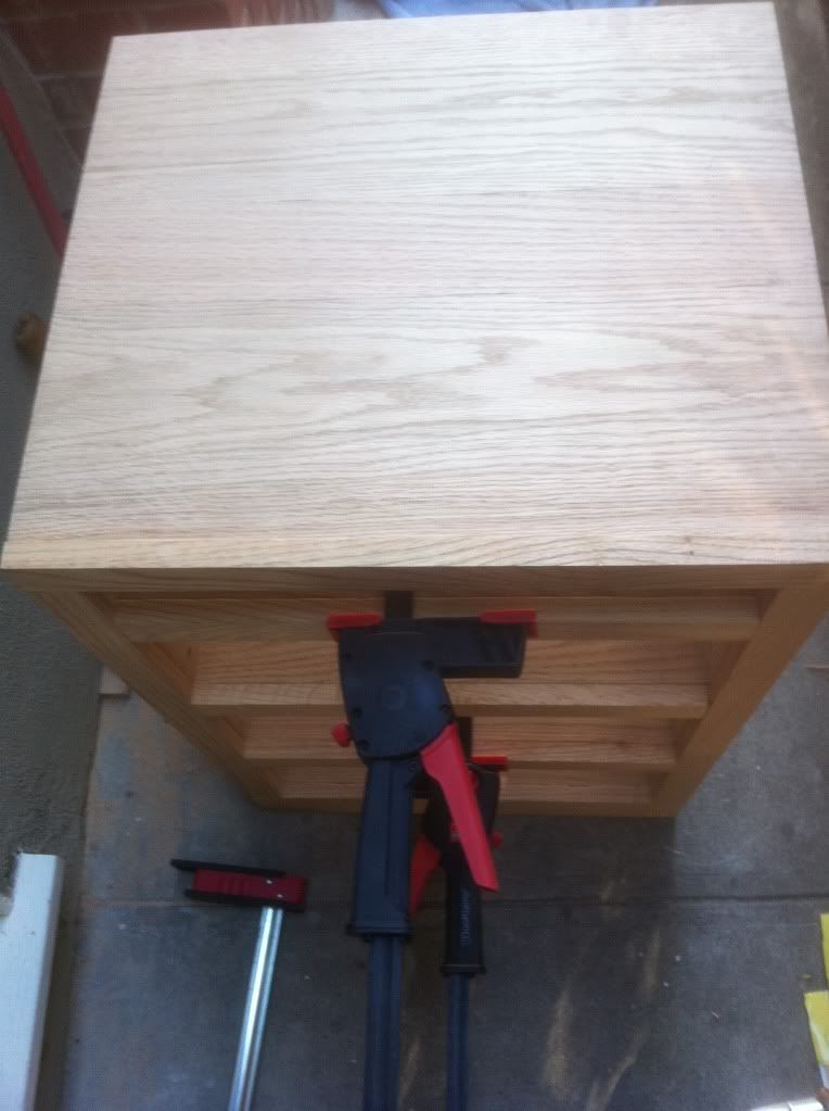

Here's the pieces for the sides clamped for sanding. I don't have a jointer here so everything get sanded by hand.

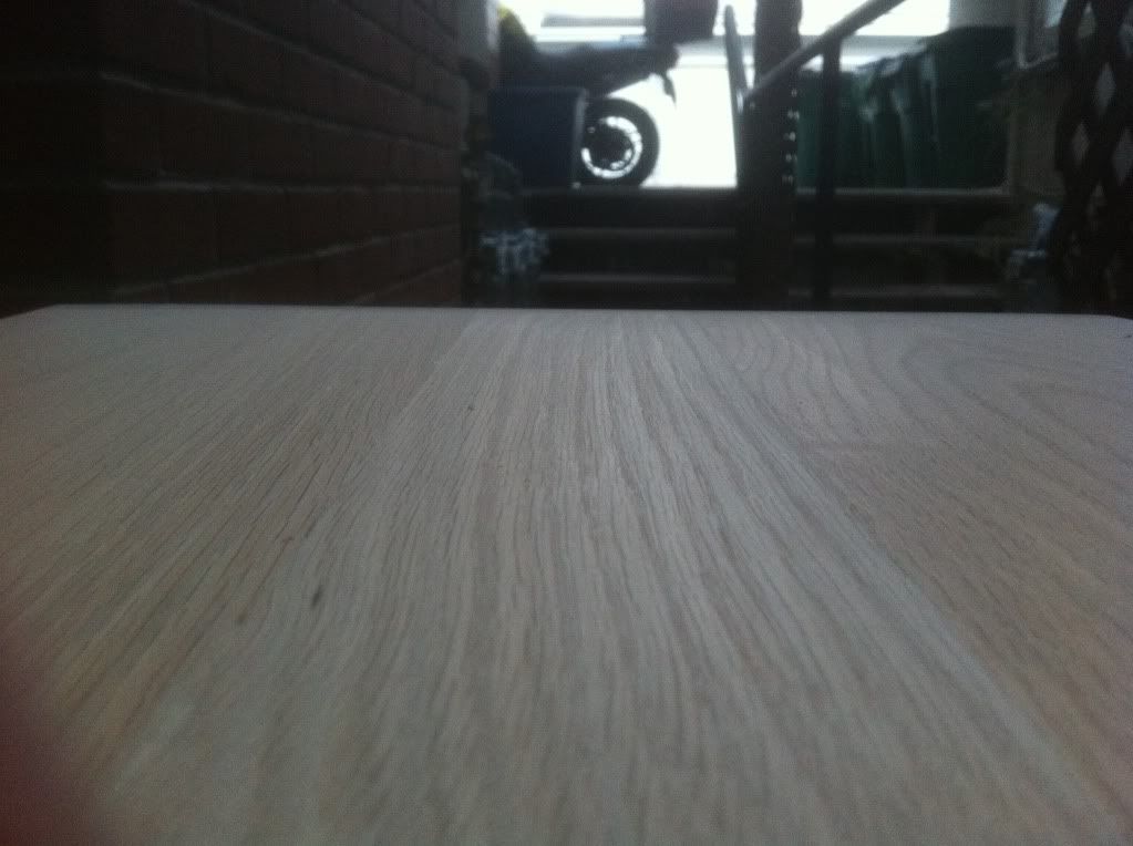

One side (laying on its side) measuring 18"x 27.25"

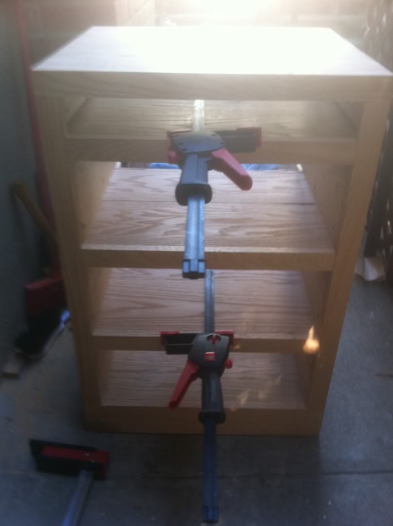

From this angle you can see the beginnings of the interior. This single piece placed horizontally marks the bottom of the cabinet. The base will create the first shelf for a UPA-1. On top of this piece, there will be another shelf. This pattern will repeat all the way up. Extra sturdy, extra heavy. 50lb casters will be on the bottom :)

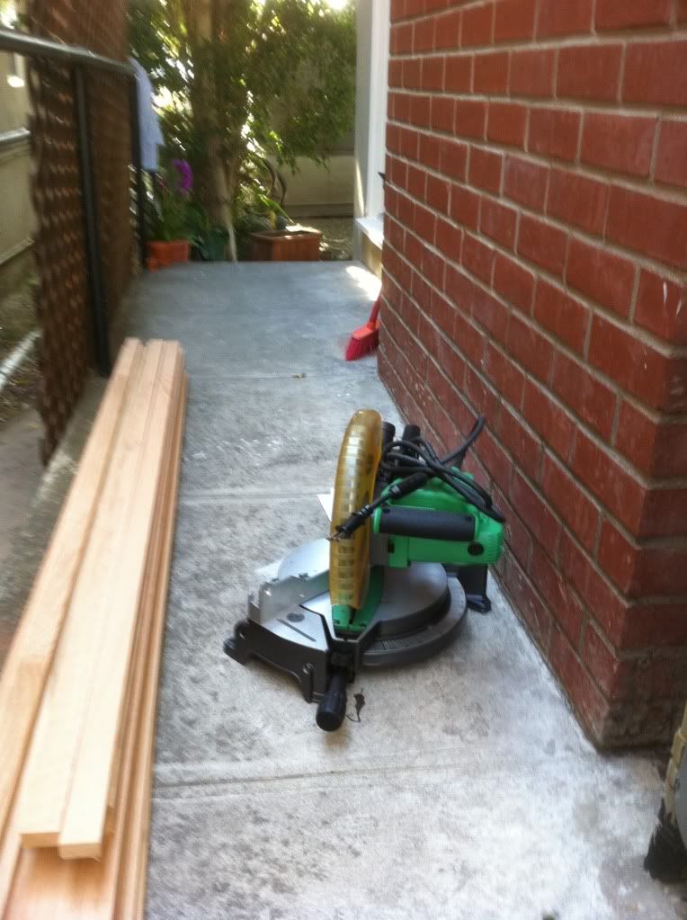

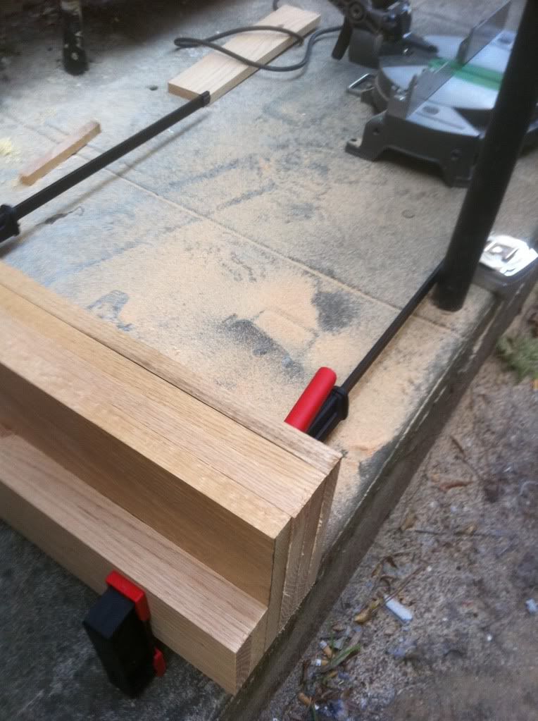

For the record, the only power tools being used are a corded drill and a miter saw. And no, a 10" blade will not cut through a 1x8, so you've got to be spot on when you flip it over. With accurate cuts, my life is made much easier. Particularly with my favorite pass time (NOT), sanding!

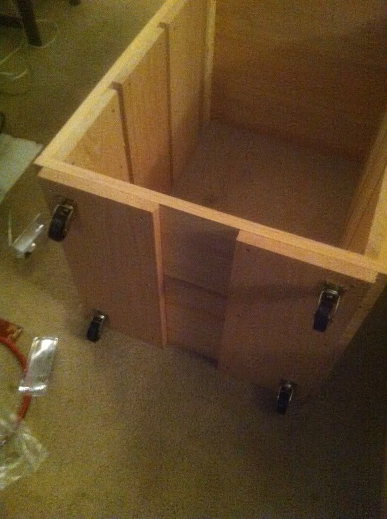

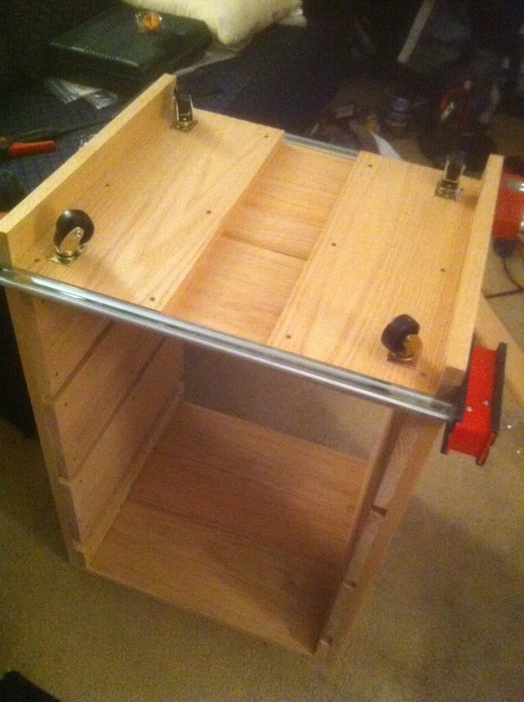

Back inside, its time to put on the casters
Gluing up the little side panels. There will be a matching front glued on before I go to bed. These boards leave about 1/2" clearance, and should hide the casters well. With the cabinet pushing 70lbs when finished, and about the same amount of weight in electronics being placed on its shelves, I used 4-50lb casters

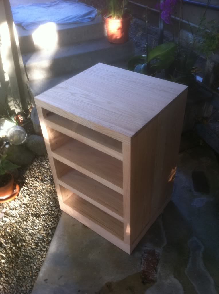

Ok, here she is with the face getting glued up, as you can see it does a nice job of hiding the cut sides of all the interior boards. It also keeps with my very plain design scheme. The amps are the star, not the cabinet.
Sanded and ready to stain

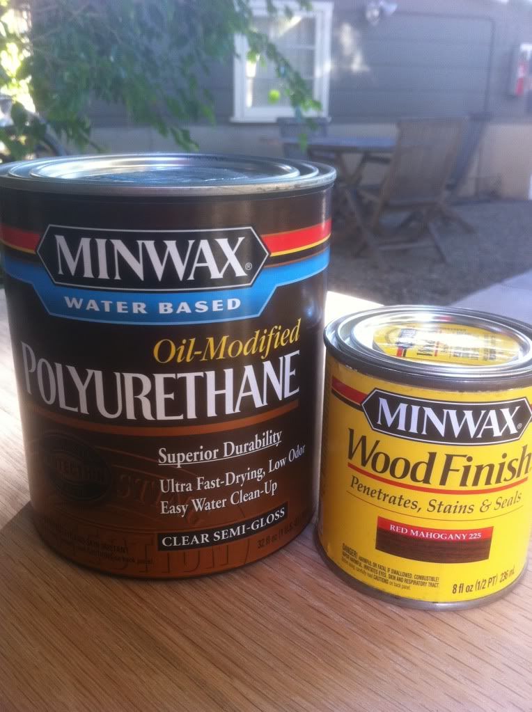

Weapons of choice
The result
Naturally, this is waaay less than ideal as the wind from the ocean blows dust all over this, but oh well. It makes me happy, and this is not for sale. The low (for so-cal) over night temps have not fully dried the stain. I'll check again in a few hours but the Polyurethane may have to wait.

The good news is that I read the Polyurethane can again and realized that because it is water based, you can apply a second coat after 2 hours. I won't be done on Tuesday, but it will still be this week. I've got a plasma to order to finish this all up!

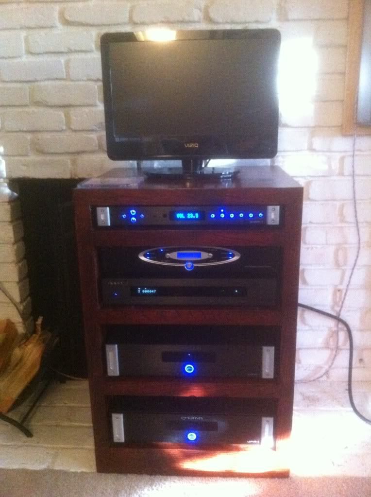

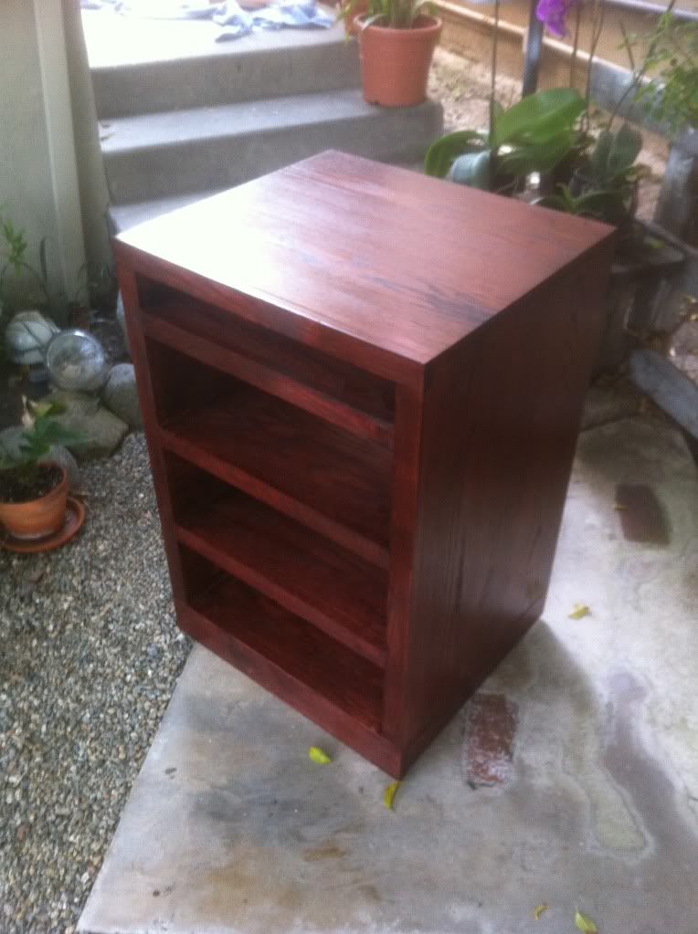

Woohoo, its done!
The cabinet is not in its final position, it'll get moved to the right when the plasma gets here. But for now, I just marvel at its beauty and that of the amps... I'm a happy camper!

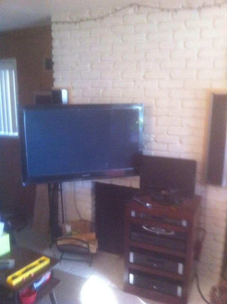

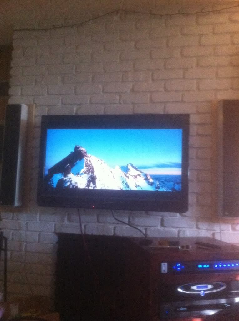

Sorry these pics didn't come out quite so well, but you can see the advantages of the Sanus VMF-220 wall mount. Two bolts into the wall, and it can handle up to a 47" TV (other mounts can handle larger sets). With this being a tiny studio beach apartment, this makes all the difference for viewing while in the kitchen, or in bed. One TV to rule them all!
Obviously hadn't moved the cabinet back in to place after having just installed the TV, but whatever. My system is now complete! Details are the hiding of the wires and the staining of the backing panels for the speakers. But, the new development is that we're going to enjoy our last summer here in Laguna, and then to blow this popsicle stand and head back to Atlanta. So I may never get around to this...

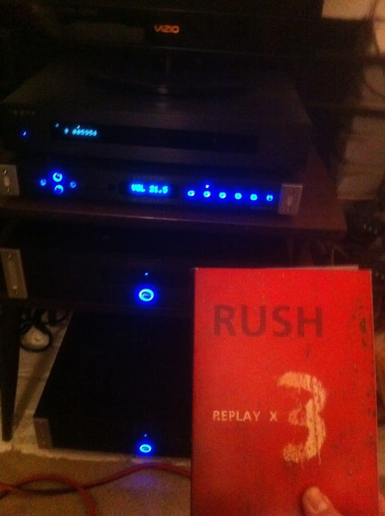

The Emotiva equipment XDA-1, and dual UPA-1's have raised the bar. Effortless sound. They do it all for low level lounge listening, to high impact movie watching. The 12V triggers do their job, so everything can be controlled through the neat little aluminum remote. I love that thing. Its a brick! They're only limited by my RBH WM-30's. Once we get settled in Atl, I intend to upgrade them with some DIY towers (looking at the 2.5 Revelators, or if I stay stereo, Orions). Nothing against manufacturers, I just love building and tinkering, and had never before considered building my own speakers. To show my geek, I compare this to constructing my own lightsaber.
