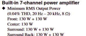

looking to finally upgrade my system...
I saw in the audioholic review of the Aventage RX A6A :
My 2500 states 7 channels 130w 20-20k .04% - states nothing about limiting.
Since I frequently listen to music in 7 channel stereo this has me concerned regarding new receivers on the market and potential clipping.
Thank for any input ! Merry Christmas !
That's two channels your listing for the power, not 7 FWIW. You should expect similar type performance if replacing with the one you linked. It only takes a watt to get loud, but it's still stressful to ask any avr's amplifier channels to play the same content across 7 speakers at very loud SPL.
B
bimmerdon
everettT : "That's two channels your listing for the power, not 7 FWIW"
.... this from the manual :
this does not look like they are admitting to limiting power with all 7 driven - thought ? . unless they were less specific back in 2004 ?

They are and while every channel has the same amp, there's absolutely no way that the power supply can handle that all at once. The Audioholics review confirmed the two channel output. Most people have zero real world need for 7 channels playing equal content. If it is a concern,. You'll have a add an external amp, however I'm assuming (believe) that it won't be an issue. I owned the 2500 and it was a very fine AV reciever, but with HDMI boards and additional processing, things have changed and so have some goals.

The way I read the spec in the manual they're just saying 1 ch driven rating is 130 W. Each channel is capable of that at a given time, which is fairly typical of avrs; some give a 2ch driven rating, tho. In surround formats it would be very unusual to need simultaneous full power to all channels.....maybe if you're pushing a multich stereo mode with full range speakers (no sub) then that could be a bit too much for it...
Did you read the bench tests done in that Audioholics article? Certainly doesn't look like it's capable of all 7ch driven at 130wpc....
