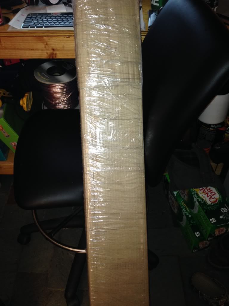

Well I got my lumber in for the front baffle. Unfortunately for me, I'm not unwrapping it. Just slapping a shipping label on it and sending it back out into the world. I decided I really wanted to get these top baffles right and wood is too expensive for me to butcher it, so I'm getting the baffles CNC machined. I'll still have to put the round overs on and make the section for the rear tweeter, but I think I can handle that.

So, you're going to have the lumber you recvd cnc'd? If so, cool, worth the extra expense-err..investment!
agreed on the ups tracking/ my ups thing.. pita!

Indeed. I decided this is going to be my solid hardwood build, and I sprung for some pretty sweet looking lumber for the baffles. I figured that after spending $150 on the lumber alone, another few bucks to get them machined would be worth it. Plus those curves would've been hard to set up and then cut. I did 85-90% of the work on the files so it saved me a ton of money since cutting is relatively cheap. Next up is probably the lower mid-woofers and then sometime next month I'll order the side panel material, which I am extremely excited about.
Still haven't received the updated build diagrams for the woofer section, but at this rate it's not a big deal at all.
Note to self, building your own speakers is easy if you just keep throwing money at the problems :D

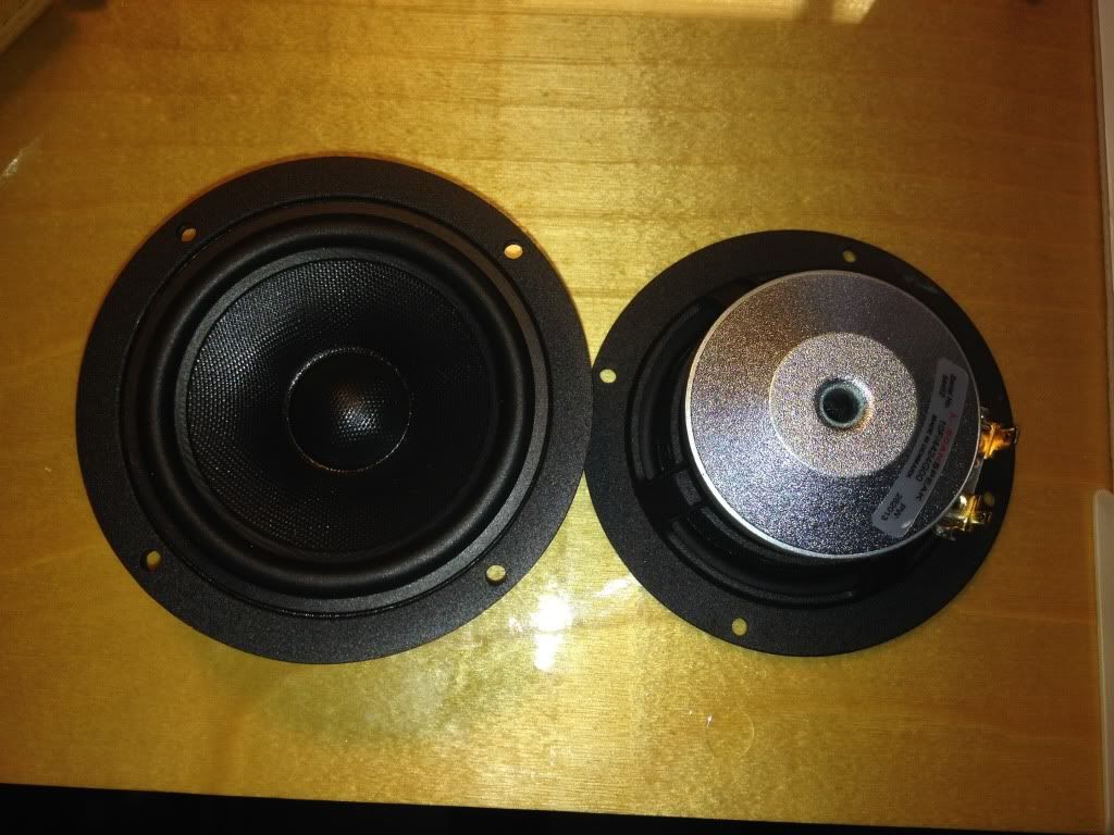

Upper mids are in. They're small, but darn are those magnets strong.
