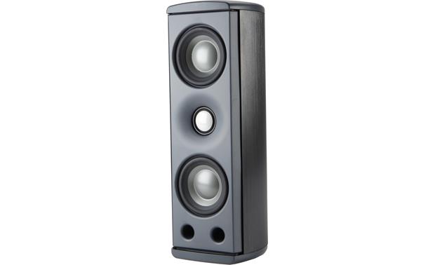

I would stay away from those MTM on-walls. MTMs have a very narrow and rocky dispersion pattern along the line of the woofers. Unless you can aim those speakers directly at the listener, go with a more conventional design.
I understand what you are saying, but my understanding is that these are intended to be mounted vertically such that the line of the woofers is up-down, while the LPs will be horizontal, thus avoiding the rocky dispersion pattern. But you know this stuff better than I do!
What am I missing?
What am I missing?
The problem is that when you orient an MTM vertically, the vertical dispersion becomes very narrow. So let's say you mounted one higher up, as most surround speakers tend to be mounted, well unless it is angled downward so that the tweeter has a vector with the listener's ears, the listener is going to be seated in a large null which will eliminate most of the midrange.
Good point, I wasn't considering mounting them high (because I understand the problem), but most people seem to (I assume mainly to keep them out of harms way)!
