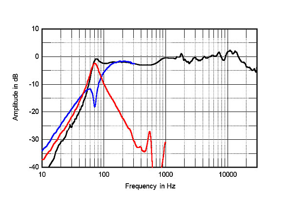

Reason 1) I am comparing two subwoofers to see which I prefer. I don't know for certain how I will use the subs in the future, so thought it a good idea to run them wider range (80Hz instead of 60).
Reason 2) For the comparison, I am using Pioneer BS-22's because I could get my hands on 4 of them (2 systems to allow A-B'ing). With the 4" woofer and Pioneer's published FR of 55-20kHz, 60Hz seemed to be stretching things. Now that I have pulled up a measured FR, I'm thinking I probably should move it all of the way to 100Hz. What do you think?
http://www.stereophile.com/content/pioneer-sp-bs22-lr-loudspeaker-measurements

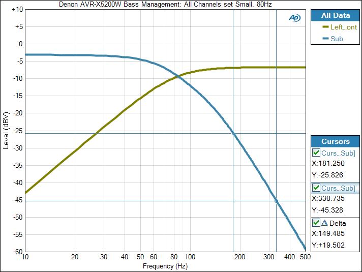

I have wondered, how steep is the cutoff at the crossover point within AVRs? Is it a sharp digital vertical slope, or is it an analog roll off?
From Gene's review of the Denon AVR-X5200W:
Bass Management
Denon has always had some of the most flexible bass management options of all the A/V receiver manufacturers and the AVR-X5200W proved to be no exception.
Denon AVR-X5200W Frequency Response with Bass Management Engaged
With all speakers set to small and an 80Hz crossover point, I measured the outputs and crossover slopes. With a standard “small” 80Hz setting for all channels, the high pass filter (HPF) for the satellite speakers maintained the correct 80Hz -3dB pt with a 12 dB/octave slope. The sub out did not maintain the 24dB/octave slope we’ve been accustomed to seeing with Denon A/V receivers and THX certified products in general. Instead, I measured --8dB at 80Hz with a 19dB/octave slope. I’m a bit at odds that the sub out is a little off, but this is not a THX product and the slight difference is likely inaudible for most installs and is academic.
Now I know what is going on, I agree with you. My dislike of high Q ported speakers is well known. It has a nasty peaked port output, which to me never sounds good. I would go to 100 or 120 Hz if you can. If you go to the 100 Hz range then the sub must be in proximity to the speaker, or you will localize it.
