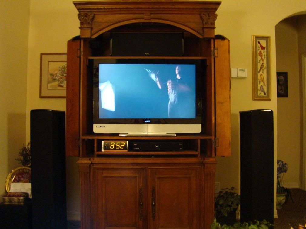

Right now (it is going to change compeltley in a month or two), I have similar but not the same set-up. I have a 37" LCD in an Amoire with a large center speaker (Def Tech CLR3000) over the TV in a three sided box so to speak. The center speaker also has an upfiring subwoofer, but I have about 4-5" overhead space. I haven't put any special acoustic or sound absorbing material, only tune and equalized all speakers with SPF. I do not notice any resonance due to the cabinet and the sound quality from the center speaker is already at an excellent level. You situtation may be different, but my amoire is very solid and seems to add no addtional noise interference or resonance.
It is black and if you look closely you can see it above the TV
Good luck!,
MidCow2
