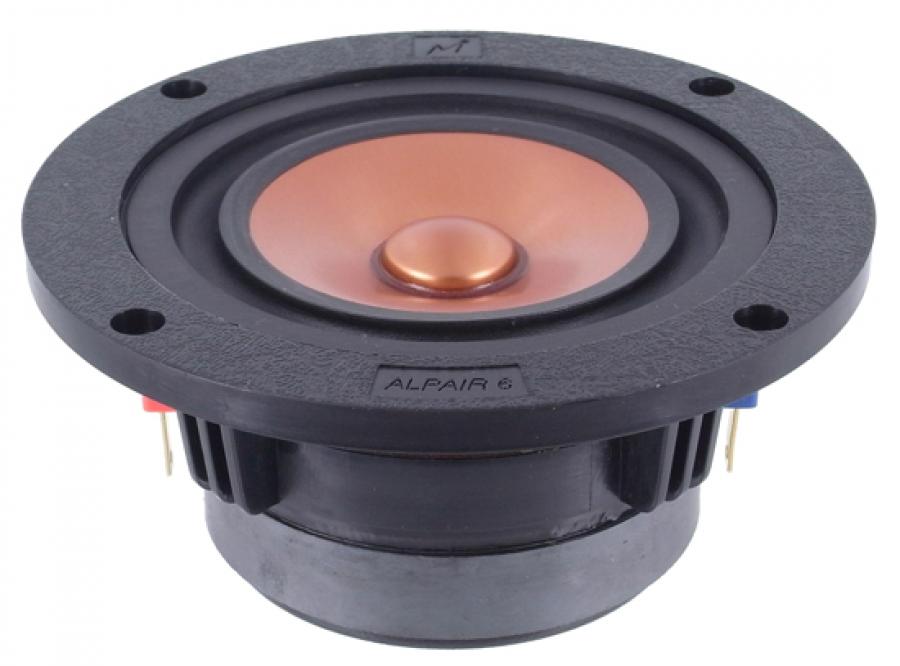

One of the new Gen 2 Mark Audio drivers, is the solution to your problem. We finally a think have a good updated heir to the Jordan Watts full range driver. These Mark units are its direct descendants. I use a single 4" Jordan Watts driver as the center in my Eagan system. It matches seamlessly with the mains, and has very good speech clarity.
This 3.5" driver will give you room to spare, and it would take very little time out from your projects to build a small sealed box for it. You can cross it over at 90 Hz. No crossover or any other drivers required.
This will be far better than any other solution for you problem, especially that Polk speaker.
These drivers should match perfectly any good and well balanced speaker.
