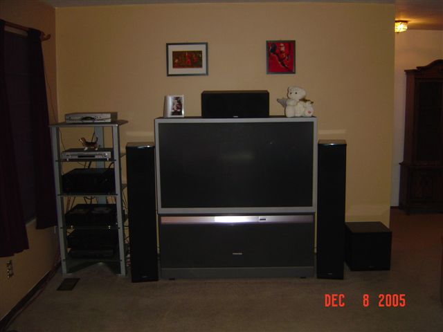

My center channel is setting on top of my tv tilted slightly down.
I will try to increase center about 2dbs to see the difference.

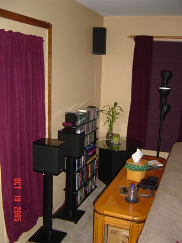

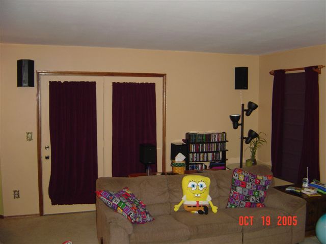

Here are a few pics of my setup.

Your mains are too close together and they should be pulled forward from the display slightly. For the center, make sure you pull it all the way out at least to the front edge of the display, if not hanging over slightly.
goodman
goodman
For increased clarity/intelligibility, I would move the three front speakers forward several inches, so that they are forward of the TV screen, not behind it as they appear to be now. In illustration, if you cup your hands on both sides of your mouth and sing, your voice is muffled. When you remove your hands from around your mouth, the intelligibility of your voice improves.
If you still have trouble hearing speech after you have moved the center speaker forward, by all means raise the volume of the center to where you can hear comfortably.

How is he going to POSSIBLY move the fronts apart more? hmm? ;)
SheepStar
PS- Nice setup, you should post it in the systems forum along with a equip. list.
