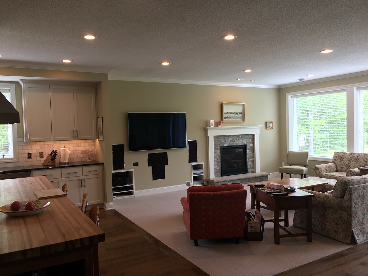

This is my solution to TV watching by the fire.
That TV is plenty high at 38" to have the center channel tweeter at 36". Now imagine that TV above the fireplace. It would be awful. Those are 9' ceilings by the way.
