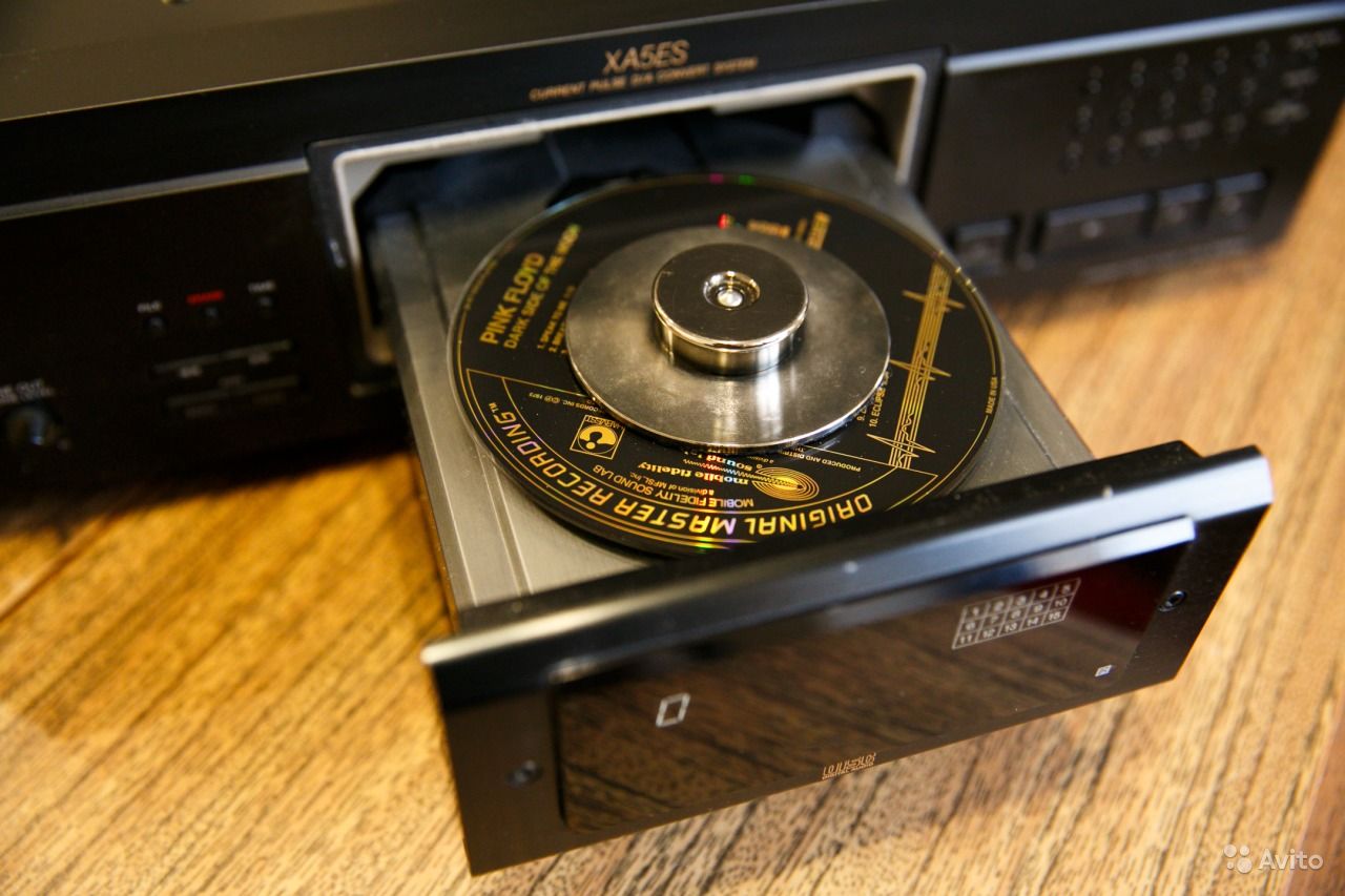

My lucky streak ended abruptly. After selling a mountain of old gear, a buyer finally asked for my CD player. It's Sony XA5ES. I've been selling it for a long time and was very happy to finally find someone. And he was a cert. He said if it looks like in the pics, he's making a reservation (and it does, it's very well kept).
After bringing it in from my family house, I noticed it fails to open the tray every now and then. (And do I hate these "every now and then" problems!! For crying out loud, is it broken or not...?) I had to call it off, I had no heart or peace of mind selling a unit in that state. I won't do it.
PROBLEM
The tray will sometime open and sometime not. There's no rule. What I did to check my first suspicion was to see if it has to do with loading the CD. When you put a CD in your player it spins and gets read for the info on the number of the songs and the overall length. I thought perhaps you can't interrupt this process and it doesn't want to eject the CD while it reads it. But it's not that.
The only thing I noticed that it will happen more often after playing a CD and less often if you just keep pressing the open/close button. But it's never 100%. Every now and then it doesn't open.
Do you know what could be the usual suspects? What to check first? Everything else works.

Not off my head but do you remember how quickly it opened after pressing the open button? Maybe you are repeating it too fast and thinks to close it?

Also, I am wondering if that weighted top platter may be it now? try it without it for a while, but you want to sell it, may not have too much time.

I've seen weights put on turntables but never on CD players. This must really be the exception and looks like another audiophool gadget to me.
Unless a CD is really warped, I don't see any need for such thing. Also, nobody needs such accessory when CDs are always kept in their case and not subjected to heat and/or humidity.
:D:D:D:D
It most definitely is audiophool! This wasn't my purchase choice, I got it. I'd say it's way overpriced and would never buy a CD player like this. I believe a new 300-400$ CD player does everything as good as this one. But the weight is not for the warped CDs since it doesn't press the CD against the flat surface of the bottom. The CD is in the air even after the weight is placed on top, so it's completely useless. But the CD is not fixed in any way without it so I don't think it'll work without the weight. And believe it or not, the audience this player was meant for want it precisely because of the weight! :rolleyes: I know!! Silly!

Sounds like the weight may be acting like a clamp so the disc can be spun? Otherwise, it would not turn well and just slip. This is nothing like a vinyl player that sits on a platter that spins.

Looks like the same/similar mechanism as my old Sony ES DVD player. I used to have a Sony service center up the street, the parts were like $40 and were easy to replace. They recommended both the belt and the flex cable.

Was the weight an accessory, or did it come as an original item?
If you look inside of most disc players, you'll see that the upper arm clamps the disc in place on the spindle and the disc spins free from the rest of the transport. This player obviously has room for this, but as I was going to write in my original post, the weight will cause the disc to spin long after it should have stopped and the spindle motor/belt may not allow the main control to recognize that it should open the drawer, which is supposed to remain closed until the disc stops spinning.
If you can remove the weight, try it that way. Look at the belt with a bright light and check for lubricant- if it has any on the belt, clean it with something that's safe for rubber. Technically, alcohol isn't good for rubber, but it's a commonly used cleaner. Also, look at the belt for the spindle, if possible- if you see ANY sagging between the motor pulley and spindle, it needs to be replaced because the tension isn't adequate.
When I was in school, we were taught the concept of 'SIB-KISS'- this means 'See It Big- Keep It Simple, Stupid' and referred to people who design, well, anything.
Original. CD comes out still spinning. I'll try to check the belt, but it's a lot of digging.
I had a similar issue on my Revox CD player before I sold it. It turned out to be the drawer motor. Finding one was not easy. I mention this, as both players had the same designer, Roger Lagadec.
