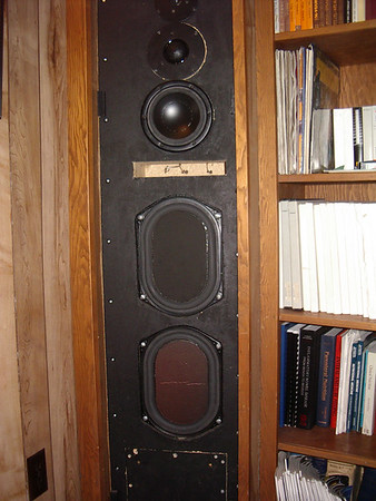

I had Bob Carver in my basement a few years back, right as the Sunfire subwoofer was being introduced. I gave him a chance to make his case about this magnetic shunt business. It was really hard for him to make a case for any benefit, and it was largely an exercise in obfuscation.
Anyhow, I was introduced to him by an acquaintance of his, who wanted to see if his Sunfire sub would best these, speakers for bass. These speakers have been reworked for my current center back speakers.
Those venerable TL loaded KEF B 139s easily bested the Sunfire prototype in quality, spl, and low end reach. The sub to me seemed like a pure toy.
As usual my amplification was Quad throughout.
