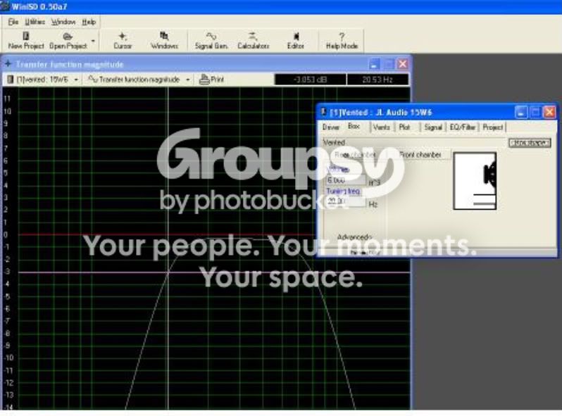

The best results I have had so far is a 6.0 cu.ft. vented enclosure tuned to 20hz with a 1.5" x 16" slot vent 22.14" long.
This enclosure yields very flat vented response with a -3db point of 20.53hz and no audible vent noise.

Guys thanks for your help. annunaki that is for one sub correct. I was messing around with WinISD and the closest I can get to that freq response with the three subs is 18 cf tuned to 20 hz with a 4.02" X 1.5 but I think that I will have a lot of port noise. Sorry I am still trying to figure the program out. I plan on using a Ber feedback destoryer as a EQ so maybe that will help:confused:.
