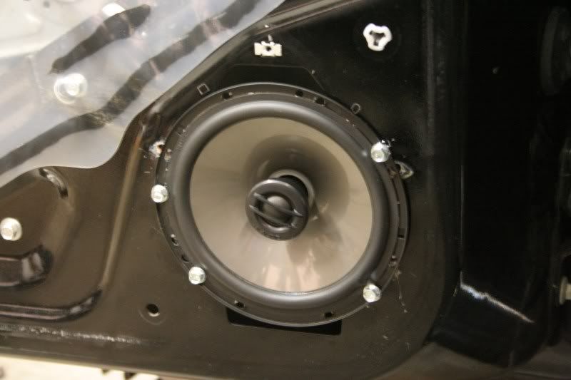

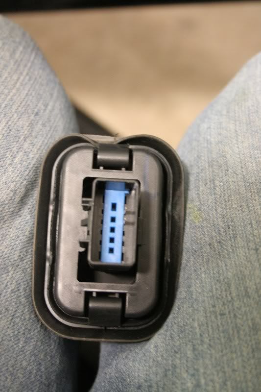

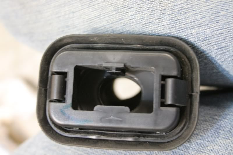

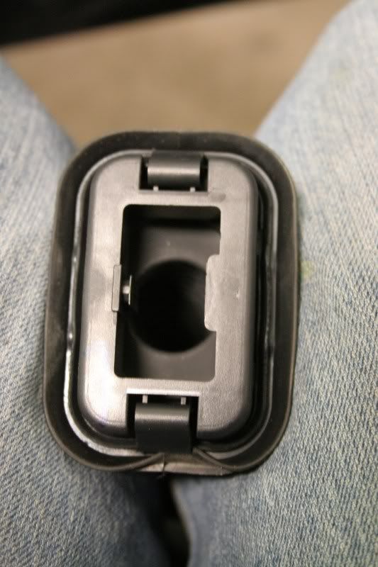

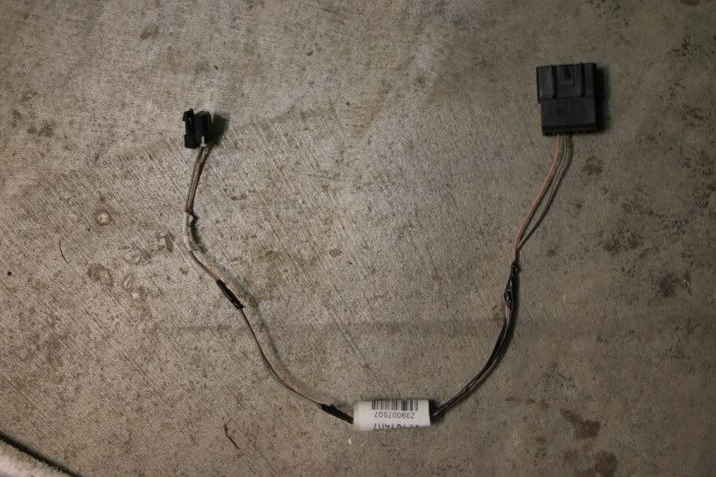

We will start with the door wiring. Since I have a 0 option car I ony had 2 small (20ga?) wires going to the door as seen here.

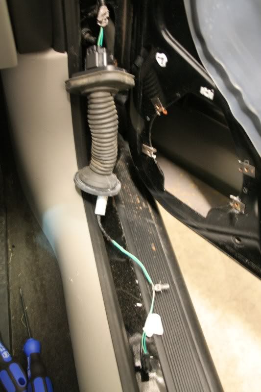

I took that out and was greeted with this.
I then decided that I could just taket that out since I dont need it for anything now, so I got this
And here is the stock wiring that came out
I then ran my new stinger 14ga wire through the stock gromets and threw in the new speakers (JL Audio C2-650x)

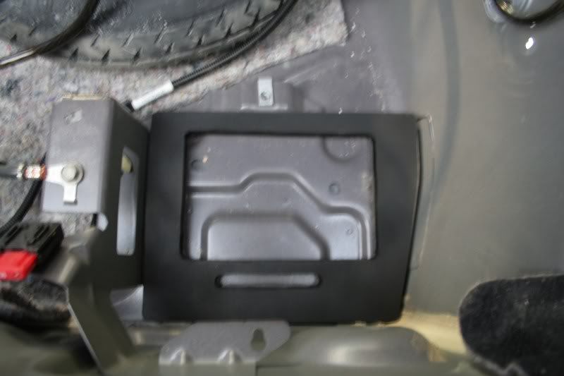

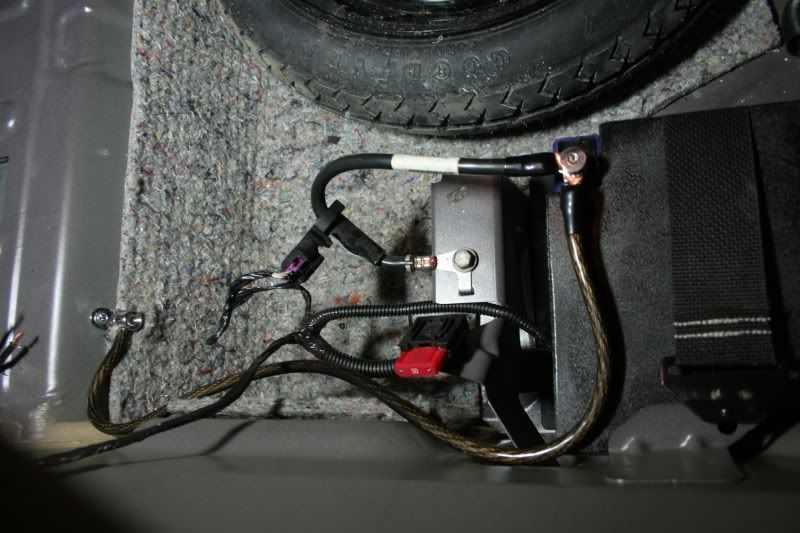

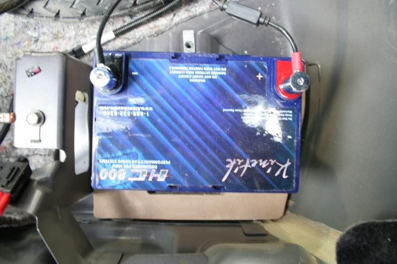

Moving on to the trunk I was changing the battery to a new Kinetic KHC800 battery, adding a ground, and redoing the amp wiring.

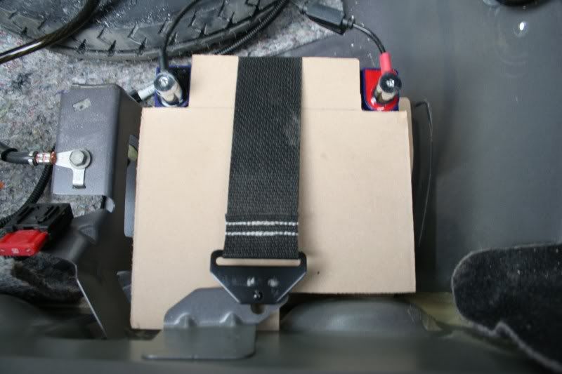

Here you can see the battery mocked up with the pices I had to make inorder to hold the battery with the factory tie down.
Here is the battery without the top piece (The wires were from a battery tender)
Here is the bottom piece to hold the battery from side to side and front to back movement.
and painted

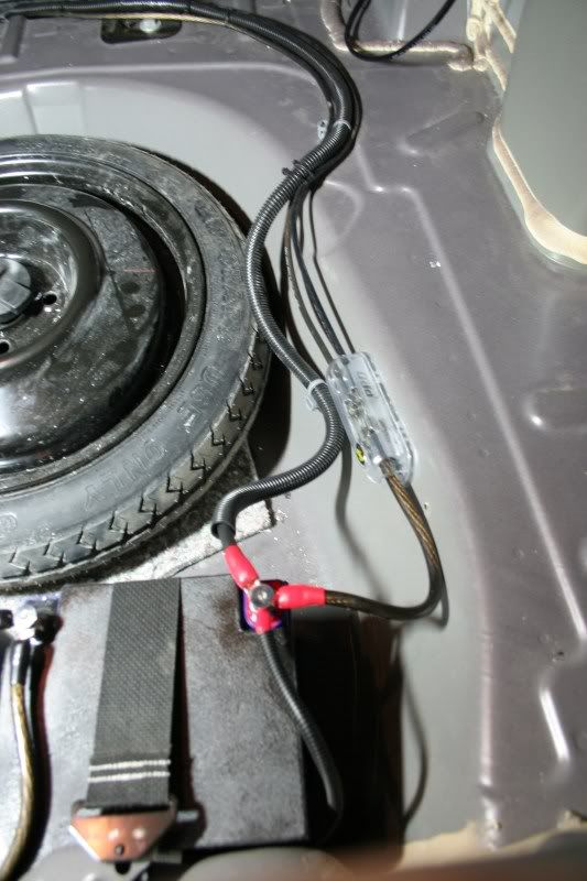

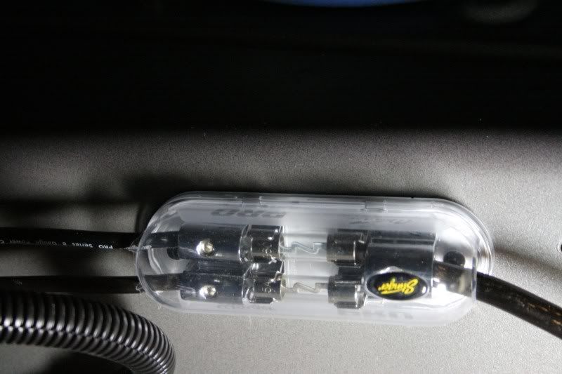

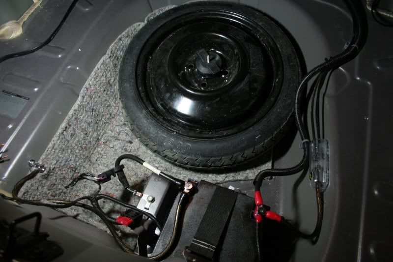

Here is the new Stinger distrobution block that has 2 seprate fuses because each amp needs a different rating. It has 4ga in and 2 8ga out.

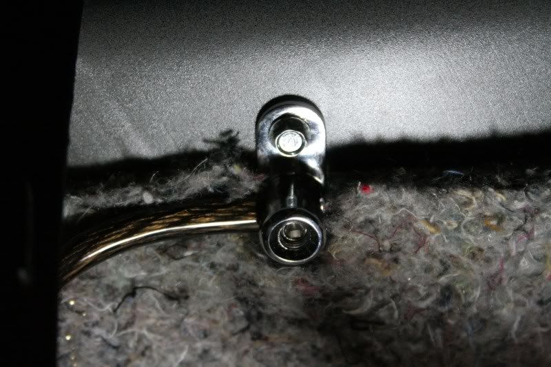

Here is new 4ga ground lug I added (the paint was ground off underneith it)
Here is a shot of all the power side of things
Here is the ground side
And over all

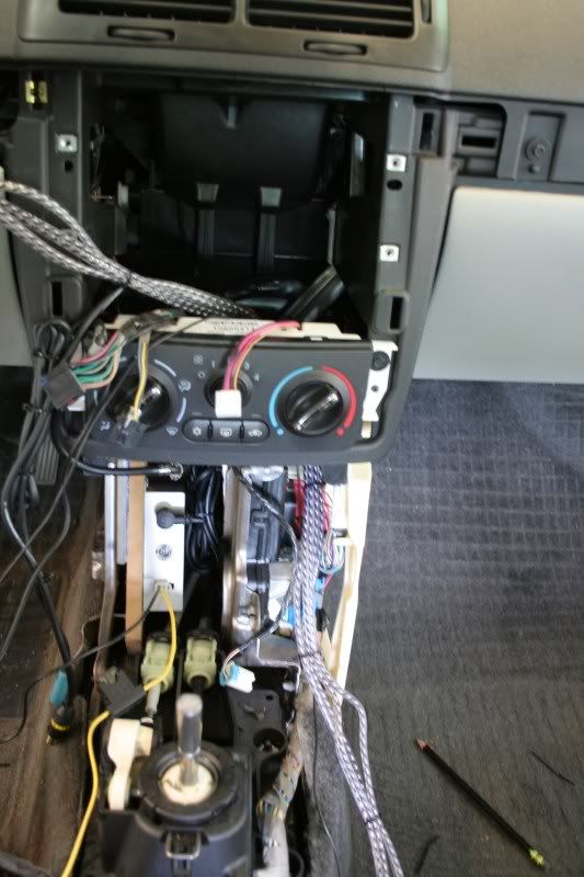

Next came running the new RCA's adding my Sirius box, and cleaning up some of my wiring behind the headunit. I didnt get many pics of all of this but you can see the sirius box on the bottom left and the strat of cleaning up the wiring.

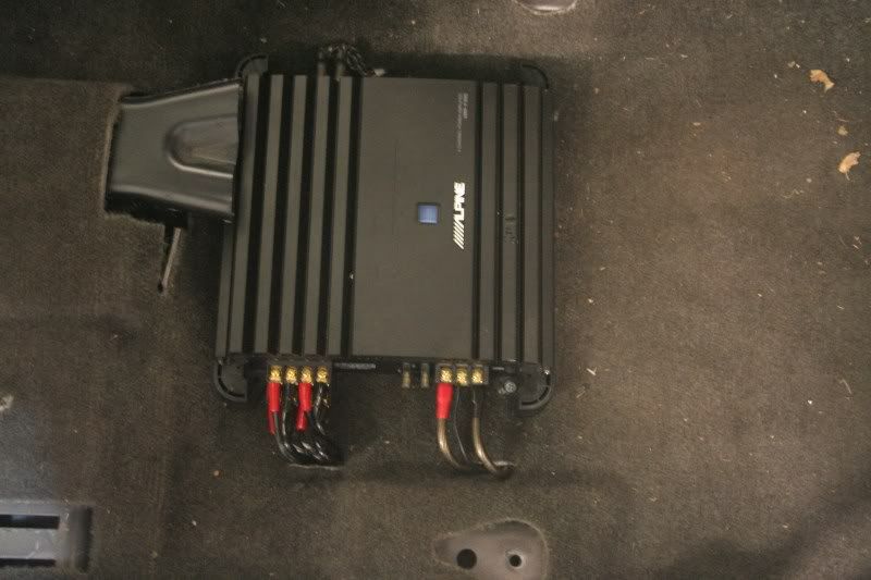

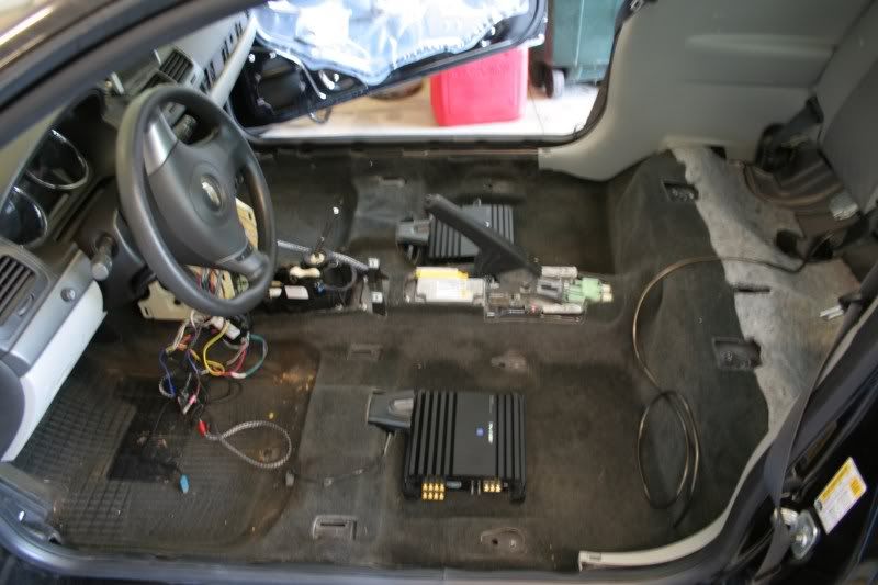

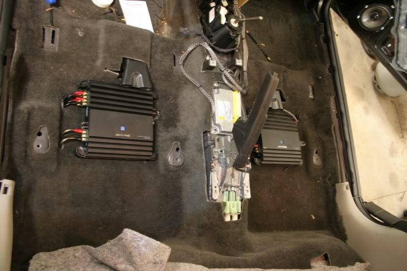

Now the best part, installing the new amp!! Here is just seeing how it will look (you can see some of the mess in this pic)
Installed
And both together
