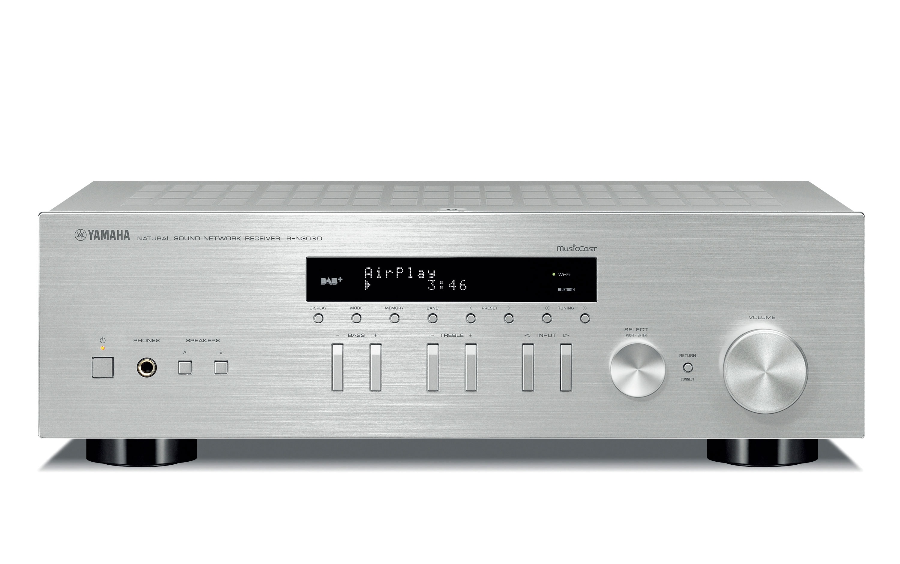

The 2 amplifiers that I found available to buy, at a reasonable price, that can be hooked up to TV and PC are the following - 1st choice is Emotiva & Yamaha
My only doubt (besides the sound output): Can this Emotiva amplifier drive the Yamaha speakers?
Emotiva - BasX TA-100
vs
Yamaha R-N303D

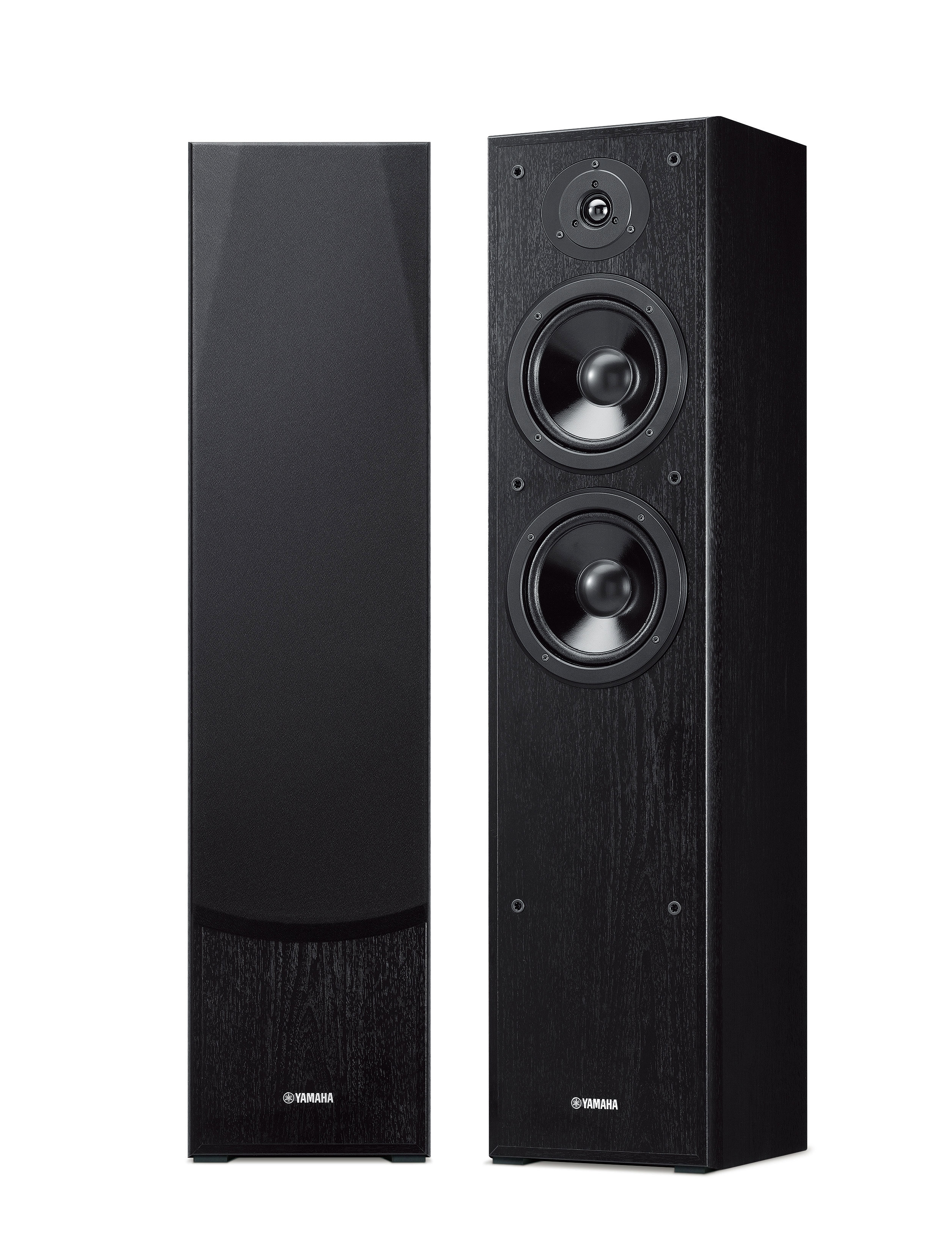

And the speakers are these:
YAMAHA NS-F51
vs
Monitor Audio 200

I'd go with those Monitor Audios before the Yamahas just my opinion
The Yamahas do seem to get some love though
I would get the Yamaha amp for sure. :D
For speakers, MA is more popular than Yamaha in general.
The two amps are fairly similar in power capabilities it looks like, altho they provide dissimilar specs. The amps will work with the speakers, tho.

I was thinking about getting the Yamaha speakers because they are 6ohm and easier to drive
For 8ohms I could get any Wharfdale, Monitor Audio etc around 300$ a pair. Problem is the amplifier
The Emotiva - BasX TA-100 only does 50 wats / channel in 8 ohms so at 6ohms it would be easier, right?

8ohm's are easier to drive
And the Monitor Audios use a really good tweeter compared to the Yamahas

Monitor for speakers.
The Emotiva will put out more than 50 watts at 60 Ohms. I would guess in the range of 60 to 70 watts.
Emotiva rates it at 90w into 4 ohms (1khz less than 1% thd), and a nominal 8 ohm rating only means so much, too. The amp desired is more about how far from the speakers and the spl you want than just what the speakers are rated as/for.
