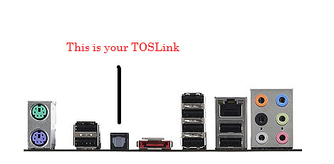

I used to think that the only audio outputs were the 3.5mm jacks but I've just had a closer look at the specs and it has a "Optical S/PDIF out port at back I/O". Could this be used to connect it to a reciever?
Click on this link to see details of my PC motherboard. www.asus.com/product.aspx?P_ID=e7Zic83PvQSr80Lm

you will want to use the optical out on your computer, receivers are receivers so you should just look at them and pick one, keep in mind if you get a 7.1 channel receiver you can get 7.1 from it even though your soundcard only does 5.1 using PLIIx

You are either going to do 6 analog outs (L/C/R + Rear L/R + Sub Channel) or you will use a single TOSLink cable to a receiver.
Your best bet is using TOSLink. Your computer won't have to bother with doing any decoding of the audio. This will be done on the receiver. It is also less of a cable mess.
