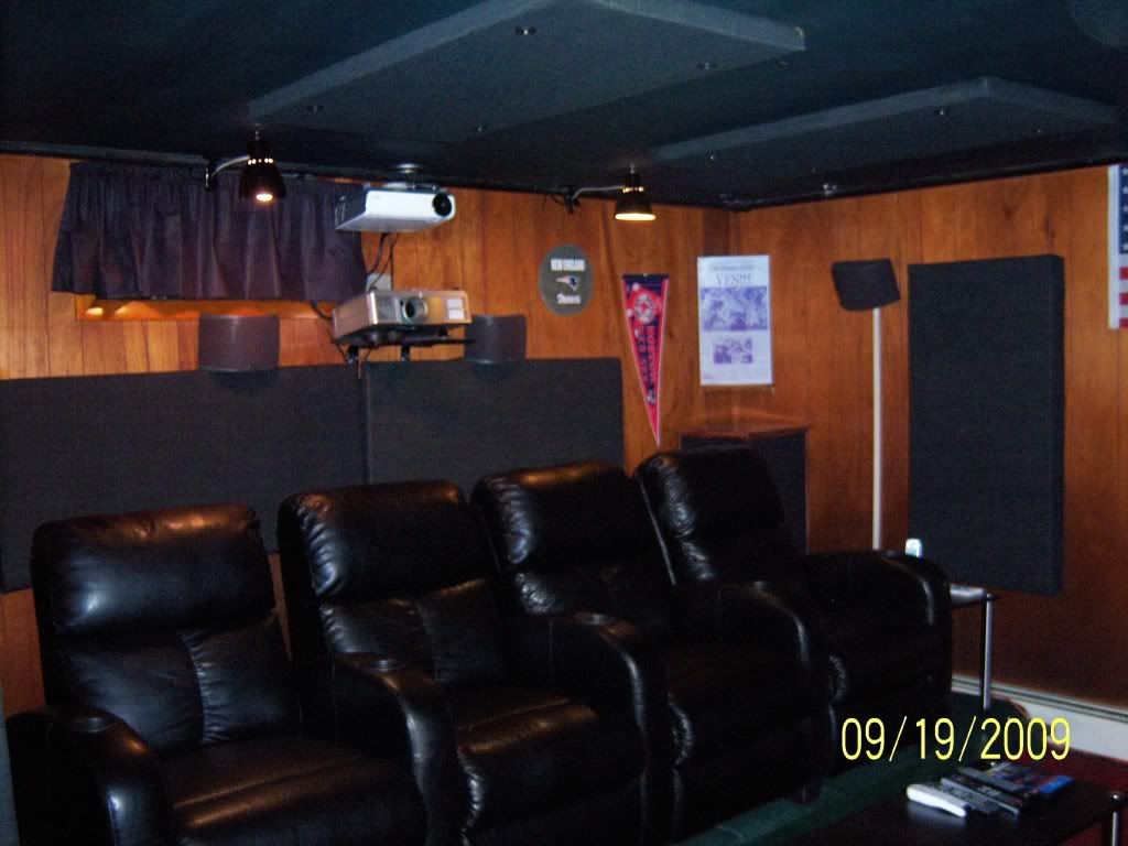

I put mine right behind the couch. It works great for me. Here is a pic now but the seats used to be up against the wall...

Sorry, but it works great for me, the OP should try it and see what he thinks. Just saying it won't work is, well just not correct.
