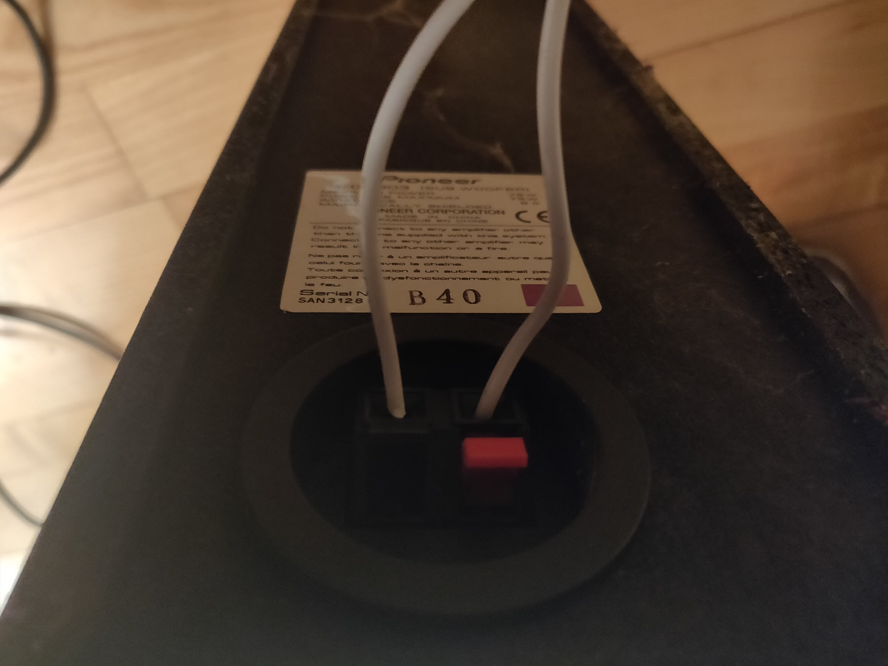

Another question in this regards - The actual subwoofer has 'regular' speaker terminals, whereas the terminals on the receiver that are labeled subwoofer has what I believe is a digital coax cable connection for the subwoofer(s).
Any suggestions how I should connect this subwoofer? Can I connect them to one of the 'Surround Back's and then assign them as subwoofer in the AVR configuration?

lovinthehd is correct.. and my apologies. I did not look closely enough ; looking only at the wattage/resistance on the main speakers. I should have taken a closer look at the entire setup.
You *can* connect the speakers (other than the sub), but I would not suggest that your would get good results from it. You will not have success with the sub as (as lovinthehd pointed out) it's passive and there's no amplified channel on your AVR for that.
If at all possible; I would recommend replacing the speakers. I don't believe you will get results you will enjoy out of the setup you are contemplating.
"whereas the terminals on the receiver that are labeled subwoofer has what I believe is a digital coax cable connection for the subwoofer(s). "
There's nothing digital about them. They are analog coax "pre-out" ports... though the literal cable is the same regardless.
