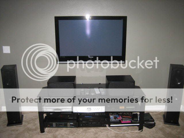

Well right now they are on a flat panel tv stand. Should they be close together or separate. They are being run by an Onkyo TXSR700 receiver through an Ashly FTX1501 amplifier. The mains are run through the Musical Fidelity 3.2cr integrated amp and the Onkyo is only running the SFX speakers. Something just doesn't sound right. I'm thinking it's the Onkyo but I don't know. When I run all the speakers where they are at with the Musical Fidelity it sounds great. Any suggestions????!!!

That setup looks like you have a couple of interesting challenges. I'd bet there are some fun interference pattern nodes from both of those front speakers the way you've got them separated (does the sound change as you move off-axis from the 'ideal' listening position?), and there would definitely need to be some distance compensation since the fronts are significantly closer to the listener than are the Front L&R towers.
You have some work to do since you are using separate amplifiers. It's not a bad thing, it just takes a little extra effort.
If you had the room (no pun intended), I'd move up those towers (don't move the centers back on that table!) to be the same distance from the listener as the fronts (unless you like playing with delays on the amps). That's going to affect your apparent LF base extension, since I don't see a subwoofer. Then again, they're far enough from the corners already that you may not see too much additional low frequency base attenuation ('roll-off').
I'd also move the fronts together and experiment with the tweeter in/out configuration (I'd bet with those speakers that the "woofer in" config would be best). I would also get an SPL meter from Radio Shack, and balance the output of the speakers from the listening position. Get yourself a couple of small, soft objects (little stick-on rubber feet work great) and angle the fronts up to point directly at head-level at the listening position (unless you're sitting on the floor ;) ).
Ideally, the speakers should be at the same distance as the display, but I've seen plenty like yours that sounded great. :)
This is my .02, as always YMMV*

I got the room to move the speaker forward, got the spl meter and they are balanced. The config they are in is with the woofers inside. I will try moving the towers forward, the centers closer together,and putting rubber feet on the center aming them up. The subwoofer will be bought within a couple of months. I just don't know which to get either!! Thanks !!!!!! Any suggestions??

Balance them again after you move the towers forward.

It appears you have the room to set them upright, have you tried both? Also maybe trying to put them closer or just eliminating one alltogether...
You have a ton of options, I would put a song on repeat and keep trying them until you like one best...then tweak from there!!
