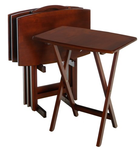

There are some setups where people don't have room to place their centers and they use a small dinner table in front of the TV like this:
Obviously not as inexpensive as a folding table, but Sanus and a few others make stands for centers:

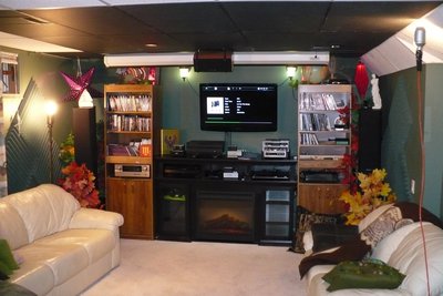

HT%20Pix.jpg Agree with the angle towards your ears, that is all I needed to do, just fiddle with the angle until it sounds right, it can take some back-and forth. I have mine hung with bungee cords, works great. and when the lights are low, you cannot even notice the centre channel up there. I also like your idea of the bigger centre channle. Most agree that 60-85% of all movie sound comes out of the centre
View attachment 11881 Agree with the angle towards your ears, that is all I needed to do, just fiddle with the angle until it sounds right, it can take some back-and forth. I have mine hung with bungee cords, works great. and when the lights are low, you cannot even notice the centre channel up there. I also like your idea of the bigger centre channle. Most agree that 60-85% of all movie sound comes out of the centre
That sounds exceptionally high. Dialog is anchored to the center channel, but there is plenty of sound coming from the other channels. Depending on your preferences and even your front L/R a phantom center might work perfectly. Personally, I prefer to have a center channel, but if I turn off every single other channel except the center I would not call what I hear 60-85% of movie sound at all.
