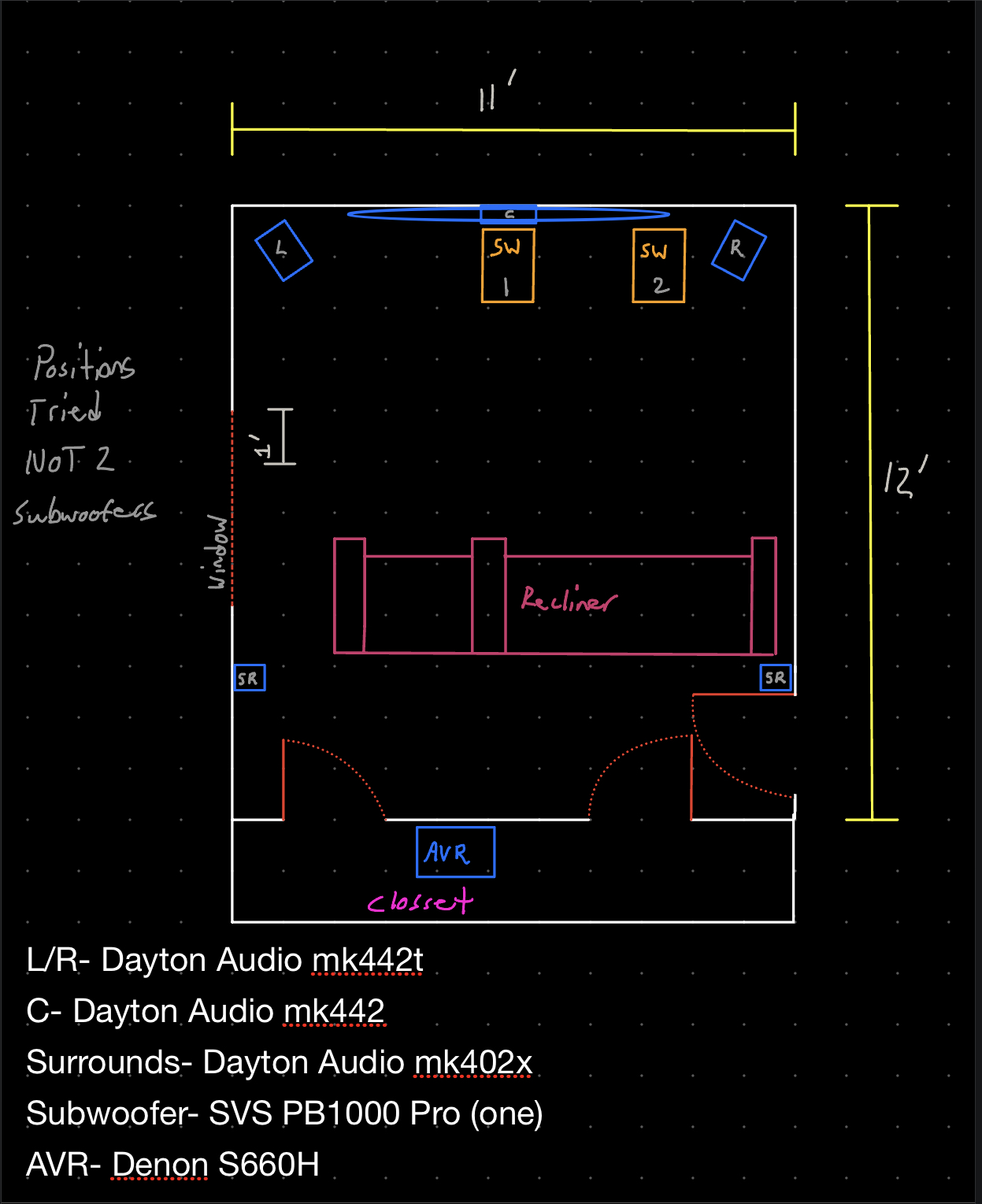

Everyone always talks about bright being the cause of hearing fatigue and pain. Is it possible to have the opposite problem? I can't seem to find as much info on the lower frequencies causing this.
I just got a new SVS pb1000 pro and I am in love, yet I found after around 30 minutes i start to get an uneasy feeling like my head is clouded. I checked the sound levels on a phone app and they averaged 65-75 db depending on what I was watching, with peaks of 85db. If I am not mistaken, this is a totally safe and level to listen at. I messed with sub volume from -10 (stock setting) all the way to -20; and while less intense, did not fix the issue.
Here is a diagram of my room layout with the positioning of everything. i only have 1 subwoofer, I am just showing you the two places I have tried. I cannot place the sub in the corners because of doors, and because of the amount of space around the tv with the tower speakers.
Window has a curtain and walls are currently empty, carpet flooring, old plaster/ sheetrock walls from the 60's.
Any advice on how to handle this would be greatly appreciated as I love the the output of this sub, and would love to be able to listen with some oomph.
Thanks!!

Is the image I attached showing up? It has a diagram, but The recliners are around 8" back from the front wall (12' total length of room) and the subwoofer has been tried directly under the center channel and next to the right channel. I cannot place it in any of the corners due to space between the wall and tv up front, and the closet doors in the rear. That leaves any central position up front, or a central position in the rear. I would like to avoid the side walls as the room is only 11' wide and with the couch only leaves a couple feet.
Yes, your diagram is showing up and helpful. Unfortunately your problem is that your room is almost square, which is a worst possible situation acoustically. This is because the wall reflections all coincide and generally produce an antinode right in the middle of the room. Another sub in the back might help, but I wouldn't count on it.
The best option is to be very judicious in the sub level and keep it well on the low side.
Rooms like that are the very devil to deal with. Rooms with a dominant dimension are always better, often referred to a shoes box rooms. There are optimum ratios for length width and height, but unless you are building a room from scratch that information is not useful.
This could be a situation where bass traps could be helpful. However, these sort of treatments need measurements and a good deal of experience to implement.
Your best option is to keep sub output low so not to excite those troublesome eigentones. Speaker selection all round can help. This is a situation where you want speakers with as low a resonance as possible. That is what is known as low Q alignments. Unfortunately good low Q speakers are far and few between.
The bottom line is that the only easy cheap solution for you is to keep the sub volumes severely moderated. One other cheap option is to experiment with moving the listening position nearer or further away from the speakers. The idea is to try and find the position of the node of the dominant eigentone, rather than the antinode.

As far as seating, the room is 12' long andI sit about 8' from the screen, I found that sitting further back is worse. I do have a curtain on the window but its a cheapie so I can try a heavier one.
The problem with putting the sub on the side wall is the lack of room. At 11' wide, with the recliners and sub its really tight, like less than a foot tight.
And I would not be opposed to different curtains and traps. The issue is that with the closet door and room entry door, rear corner traps are not possible. I can put them up front however. Do you see just having one set making a difference?
