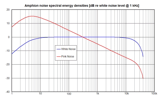

Understanding The Spectrum
If You have an RTA or spectral analizer, You begin to understand sound once You "see" how the freq´s work in the audible spectrum.
In a PC or Mac based Analysis Software You can get info, that You would never see in the SPL meter or low-price-resolution RTA´s.
Imagine that You are measuring the spl to calibrate your sub.
You have White or Pink Noise, but the speaker´s freq response is 10 dB higher in 80 Hz, the Spl meter will measure those extra 10 db´s, without noticing the peaking frequency.
There are great High-resolution analyzers based in a computer, which are cheap, easy to use and have a lot of extra tools that You can use.

You can measure the signal that goes out from the computer ( If You Go to
the Recording controls in the sound card properties, Select "Wave out", or "Stereo out " ) and see how the freq response fluctuates when You play any sound signal in the computer ( Music files, or the noise generator that is included in the software )
If You wanna go Pro, read about the transfer function, phase, and spectrogram.
