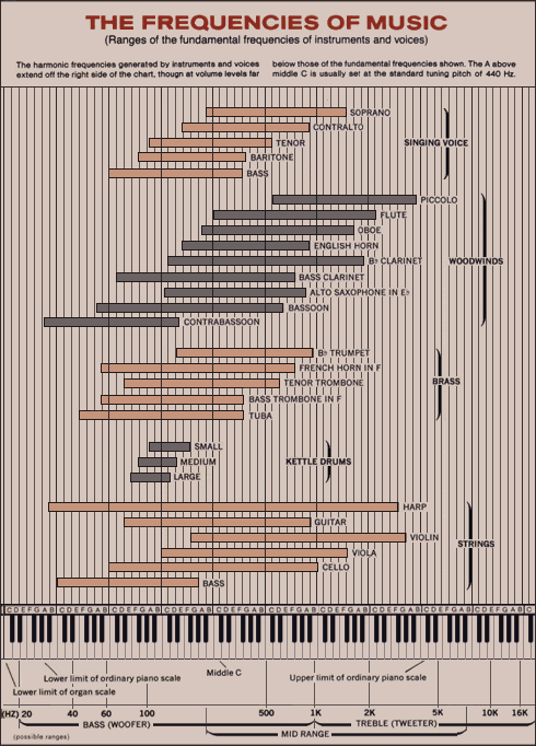

May also be interesting see the spectrums of musical instruments:
The Frequencies of Music - PSB Speakers
Those are just the fundamental frequencies, there will be huge second harmonic content also which if the fundamental X2. When I look at my DAW metering you can see the power distribution on a moment to moment basis, and the power band is primarily between 80 Hz and 5 KHz.

May be we are missing each other's point. You are correct for what you play I suppose, but not when you play something else. I was only saying you were (or would be) wrong if you meant what you said as something that is always true, i.e. generalizing..
I think you would have to play program with very little harmonic content for what I maintain not to be true. It would have to be a selection of all bass instruments, like double bass, bass brass instruments or bass guitars. That would be a limited repertory that I have not personally seen, even among the material others have brought here to master that are not my musical choice.
