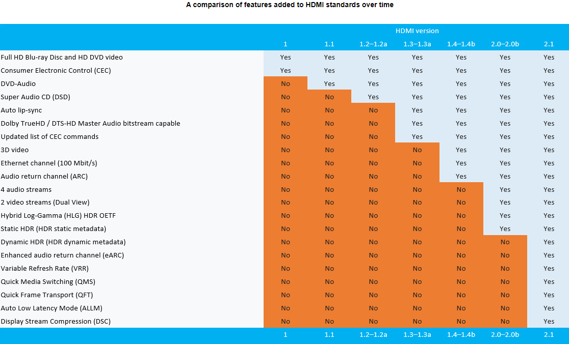

The simple answer is yes. Each generation of HDMI (specification wise) added features. If you want to have those features available, all components in the chain TV, HDMI Cable, and Receiver must meet the spec for those features.
Here's a chart you may find helpful.
I hope this is helpful.
@-Jim- that's a very nice very helpful chart for HDMI uses. Maybe a HDMI dedicated thread with that chart posted up would surely help many looking for the different HDMI cable uses.
