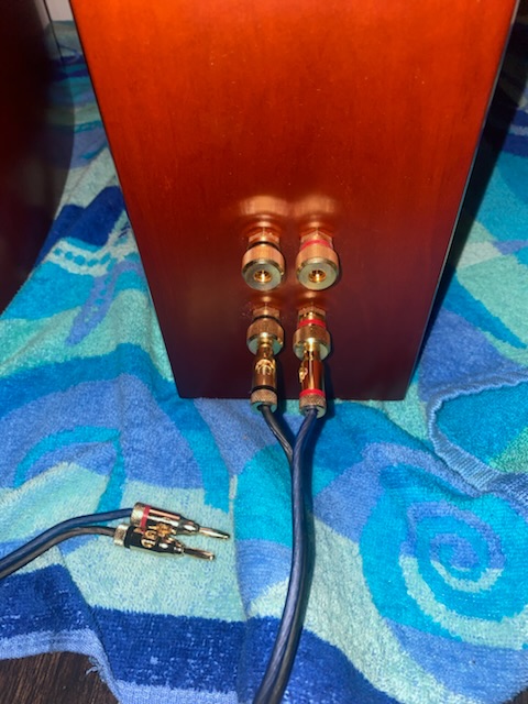

If cpp CB22 ever tries to sell his BMR Monitors, he may find those bi-ampable terminals are a plus. There will be plenty of audiophile-type buyers who won't buy speakers with only one pair of terminals on back. The same goes for having boutique caps on the XO board.
Bi-wiring is useless and a waste. When you single wire you need to put back the jumpers, between the +ve and -ve terminals. These connections need to be vertical and NOT horizontal, so each black post is connected together and each red post connected together. Don't do this wrong or you will blow up your amp, and right away.
It's funny, I bought some cheaper Polk speakers for my daughter's setup in college. They sound surprisingly well believe it or not. But I got them for $50 for the pair (towers). Got them home, sounded kinda crappy. Must be a reason why they sold them for $50. It took me about 12 hours to realize the jumpers were missing. Made some jumpers out of speaker wire. They sound great!
Yeah, don't forget to put the jumpers on or make some yourself or you will wonder what's wrong :)
