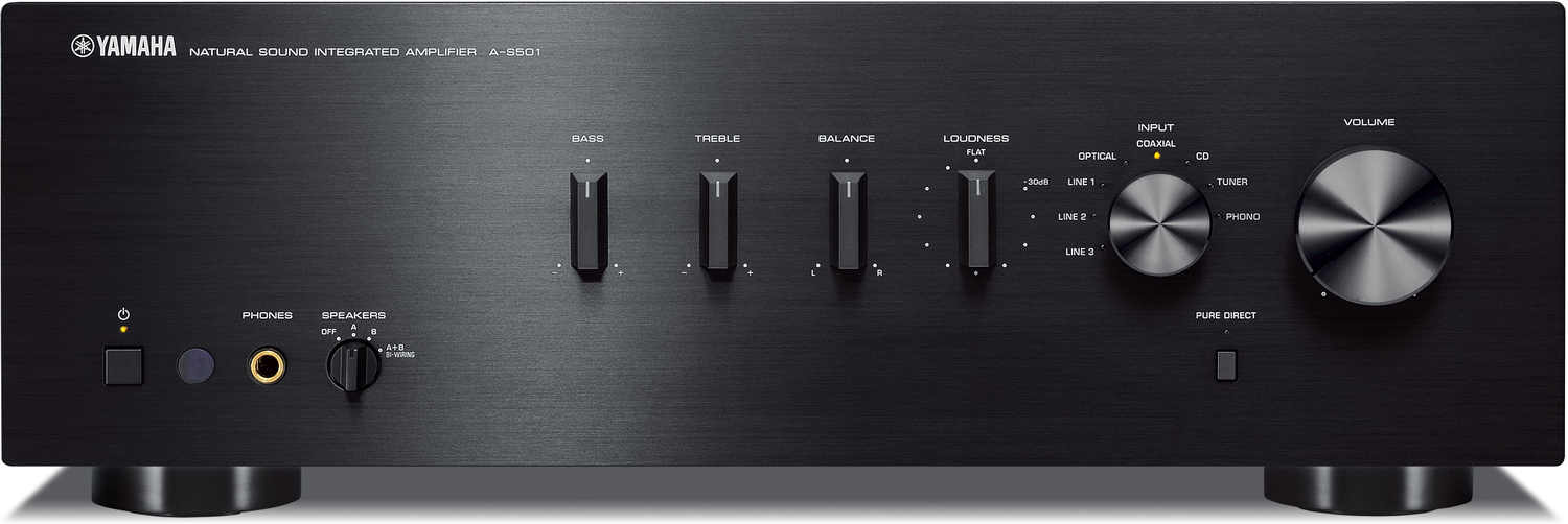

Also I've been taking a hard look at this:
Why the old amps? Just being old doesn't make it vintage :) The Kenwood's spec isn't as good as the old Yamaha, if it is still up to spec.
Personally with speakers like you're looking at I'd use a sub, and use an integrated amp/receiver with decent bass management. I don't think you get that in the 301 etc lineup of integrated amps....
