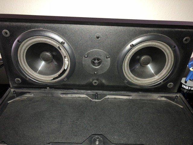

I want to make some changes for my home theater. I popped a grill off my center and starting thinking its time to upgrade.
I currently run:
Onkyo TX NR656 (Brand New)
Infinty 12 inch BU2 Subwoofer (20 Years Old)
Acoustic Research 206 HO Front Right and Left (20 Years Old)
Klipsch Reference R-25c Center Channel (Arriving this Friday)
Klipsch 1650C Cieling Speakers ( 1 Month old Dolby Atmos Speakers)
Bose Single Cube Speakers on Back wall behind couch pointing at ear level (20 Years Old)
I love the Klipsch ceiling speakers and I am hoping the center sounds equally as good. Checked all other speakers and they are in good shape.
First Question:
Should I ditch the Bose and buy 2 Klipsch R 15M?
Second Question:
Should I ditch the AR front and left and replace with 2 Klipsch R15M?
Third Question:
Is the BU2 sub out of date and in need of replacing?
My room is 16 X 15 with 8 foot ceilings. I followed the Dolby Atmos diagram for all speaker placement.

The very short answer to all of you questions (IMO) is if you have enough of a budget, yes. Having speakers tonally matched is helpful with smooth panning around the room, and IMO worth it. Some will say just let RC sort it out but I do not subscribe to the lowest common denominator ideal.
That sub, while probably decent enough in its day, is way behind. Newer models will be smoother in general and have much better extension(play deeper).
zieglj01
zieglj01
The Bose cubes do not have much frequency below 200 hz -- so yes I would replace them
I would move the AR 2060 to surrounds .... and put some Klipsch speakers up front
There are some real nice subs on the market .... if you are not happy with the Infinity sub, then replace it
