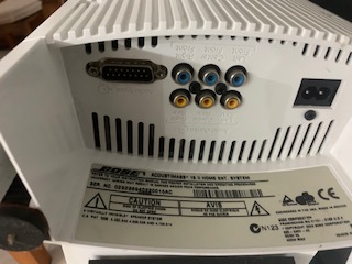

My question is I have Bose Aqustimass 15 series || and I wound like to connect to AV35 lifestyle console and have become confused as to which cable to acquire. the Aqustimass appears to have 15 pin connection does not seem to have the same but has saught of round audio out with several pins please help if you can.

While the Acoustimass module can be connected to a receiver with it’s proprietary cables, it cannot be connected to the V35 system. The V35 has it’s own proprietary connector that works with the PS48 III module.

Was going to say simply that they are not compatible. Bose may have some advice to offer you, though I doubt it will be a way to make these work together. Acoustimass and Lifestyle systems are two completely different animals.
