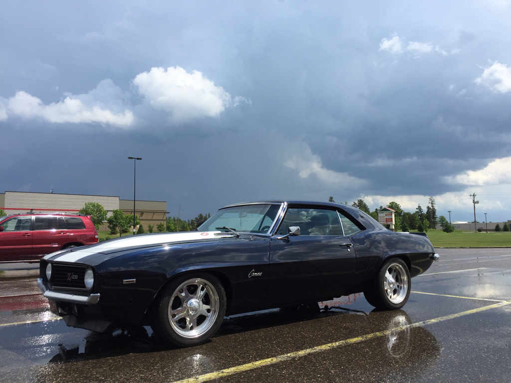

This particular car is the very first car I ever owned. I get what you mean man, the first time I ever saw it I knew it was mine, and the guy I bought it from actually had it sold, but I talked him out of selling to the other guy. That was 1994 and it was clean and looked like a Z-28. Red with white stripes. . I always loved first gens but ‘69 is the best year imo. Now it has a pro touring vibe with wilwood brakes and coilovers, and poly bushings and subframe connectors and on, and on and on...and a 4 speed automatic that still gets 3rd gear rubber. Needs a trip to the body shop but my wallet isn’t the same as it once was. Lol
“The heap”...
