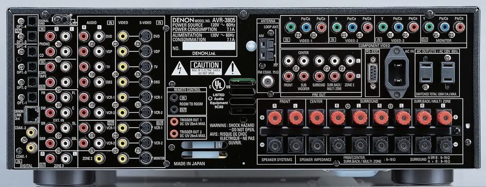

That eq will not work on a stand alone HT receiver. Today's units don't have the same type of tape loop (simple tape monitor button) as in the past. That (along with all other eq's) are for analog signals.
You can't eq a digital coax signal properly. There's a thread on this a few months back that's really informative.
The way to hook up that eq is between a pre-amp or receiver and separate power amps. I was able to hook a 10 band 2 channel eq through my Denon 3805, but had to use zone 2 and zone 1 to adjust things - a real pain in the neck. So much hassle it wasn't worth it. Plus, the 3805 has it's own internal eq that adjusts all digital and analog signals. Zone 2/3 on the Denon's only handle analog, not digital. If future units allow for digital, it could work, but not without hassle.

Which? My Denon (which is pretty generous with connections) has an EXT in, but are used for inputting multi-channel audio signals from an outboard decoder such as a DVD audio player, or a SACD player. You don't want to loop an eq through your EXT in. :D
Yup, that one doesn't. :mad:
Onkyo? The older models used to anyhow. Older Yam?
That's the big issue.
No one is going to buy an older, outdated receiver just to hook up an outboard eq. If this Denon 3805 can't do it, I don't know of any newer models that will. Thus, the reason for that huge thread on outboard eq's.
Manufacturer's really missed the boat on the new HT receivers by not having connections to easily hook up external eq's. It infuriates me to no end. I've always used outboard eq's. :mad: :mad:
