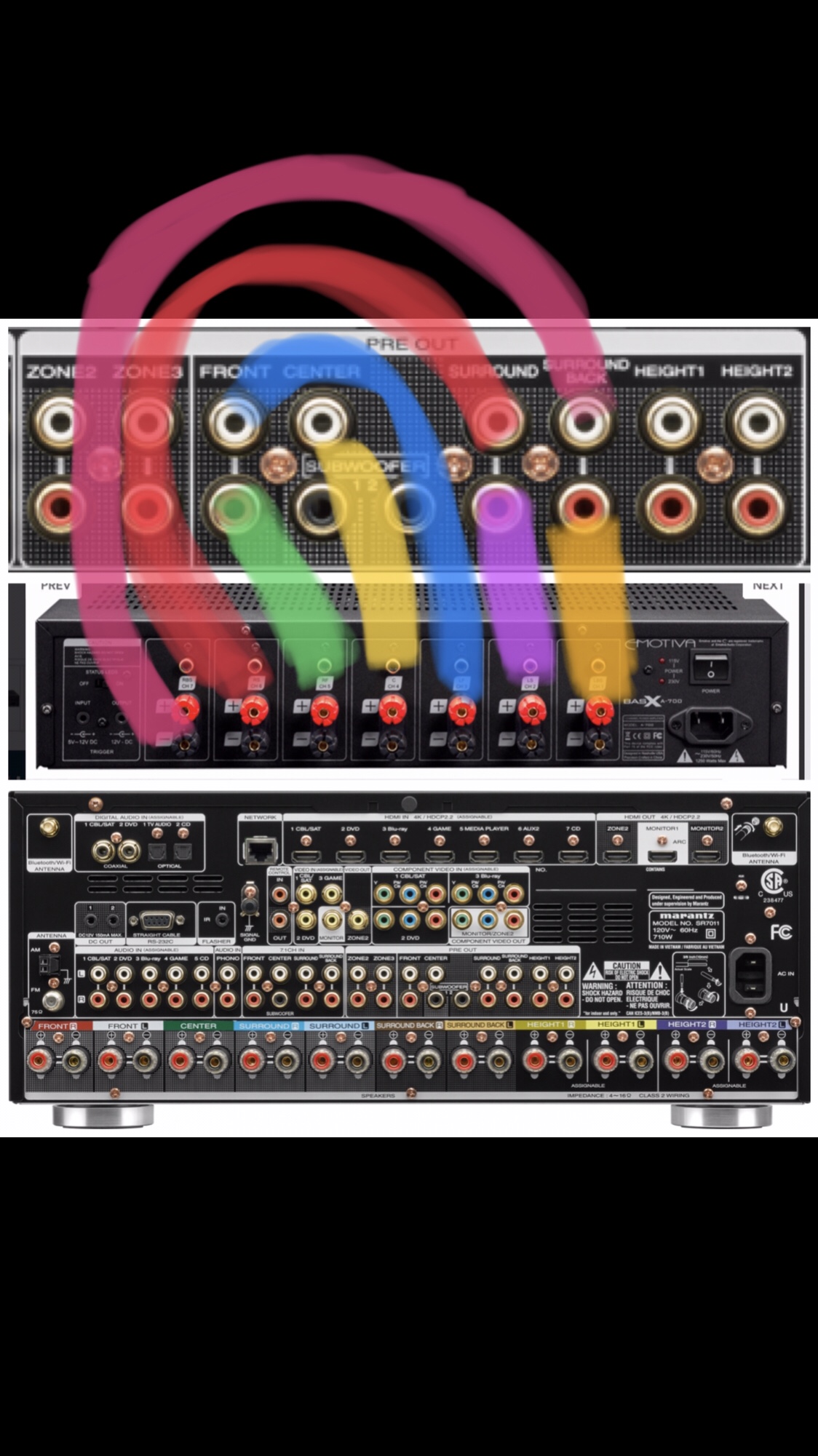

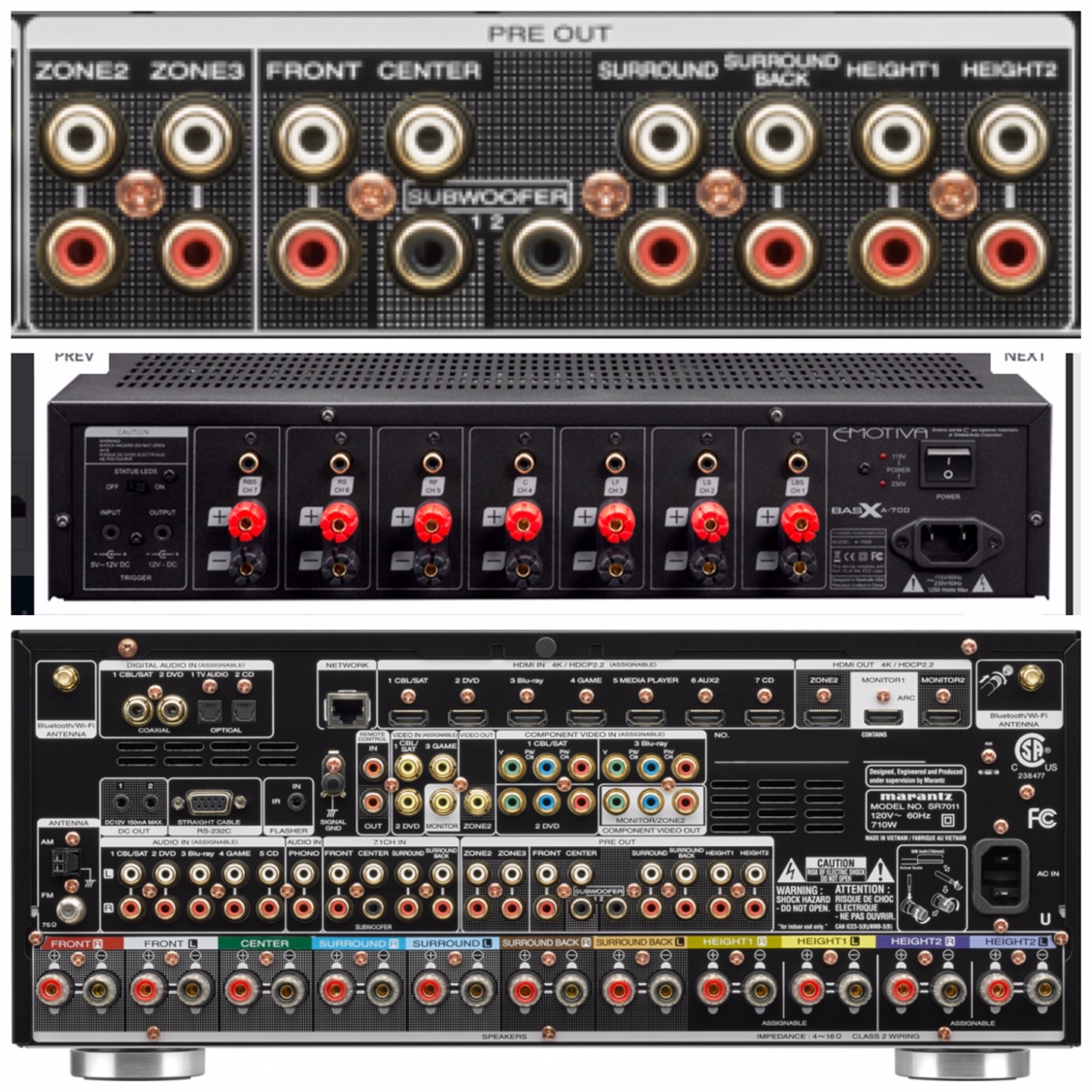

Hey Guys,
If I used my preout on my Marantz receiver centre channel to a power amp/ integrated Amp. Can I use the receiver speaker posts plus the power amps assigned centre channel speakers post to BiAmp. I can do this on the receiver but that’s at the expense of my height channels. If this is possible can I do the same for my from L & R also.
I have a Marantz SR7011 & am looking at a Emotiva BasX A-700 to achieve this. Any help would be appreciated and thank you

Hopefully this makes sense to you guys
Passive bi-amping is what doesn't make sense in the first place. Just buy a more powerful 7ch amp if you think the avr isn't sufficient. There's a second problem of gain matching the different amps.

We followed in the other thread. It's the majority opinion that your overcomplicating this. Keep your connections to the minimum. Passive Bi amping off the same power supply is worthless, biamping off of two different makes of amps dosent work. Use the KISS method
Loving beat me to it
Hopefully you didn't get sucked down the buy-wire route and feel a burning need to employ it.... :)

Thanks, point taken and lesson learned. I’ll keep me money in my pocket for the time being lol. I don’t really want to buy a new AVR for awhile as I’ve not long had the one I’ve got. Is introducing power amps to my system pointless regardless? I Mean if I purchased individual power amps and then used preouts to increase the power to my sound stage. Say a crown XLS 1502 and then went from the centre channel preout and just powered that one speaker single wired, would that make a change or still pointless? Is changing my AVR the best solution?

If you need the headroom or want to off load some work, it's all good. I personally have the front 3 in my HT seperate amped, it's been that way thru a couple of AVR upgrades
You have a nice avr. What problem are you trying to solve with additional amplification? Is there an audible issue? What speakers do you have? What is their impedance/sensitivity characteristics? How far away are you sitting from them? What spl goals do you have? What master volume setting on your calibrated avr are you listening at? These are the factors that would be more worthy of analysis than simply throwing amps at them. The difference in power between various avrs tends to be negligible and yours already has good power for an avr. A power amp twice as powerful will gain you 3dB spl but as was mentioned offloading work from the avr to an external amp isn't a bad thing, can add longevity by reducing heat in the avr. Hard to know what you "need" let alone "want" so far :)

The Auro 3D is more than just Atmos and DTS X as far as the up mix is superb. The music up mix is equally as good, but I took your point from the other thread that I maybe over complicating my system.
So I thought I’d see if I could get more out of the set up I already have by looking at BiAmping my sound stage for the best possible sound. Now listening to the guys I now know it’s a pointless exercise. Passive BiAmping is a waste, adding more speakers may cause other issues and BiAmping gives very little gain due to using the same power source.
I’m going to leave my system as is (7.2.4) and just add 3 decent power amps to my front LR&C channels and leave the rest as it is. I may look at a higher calibre Centre channel speaker as I’m fairly happy with my R&L.
