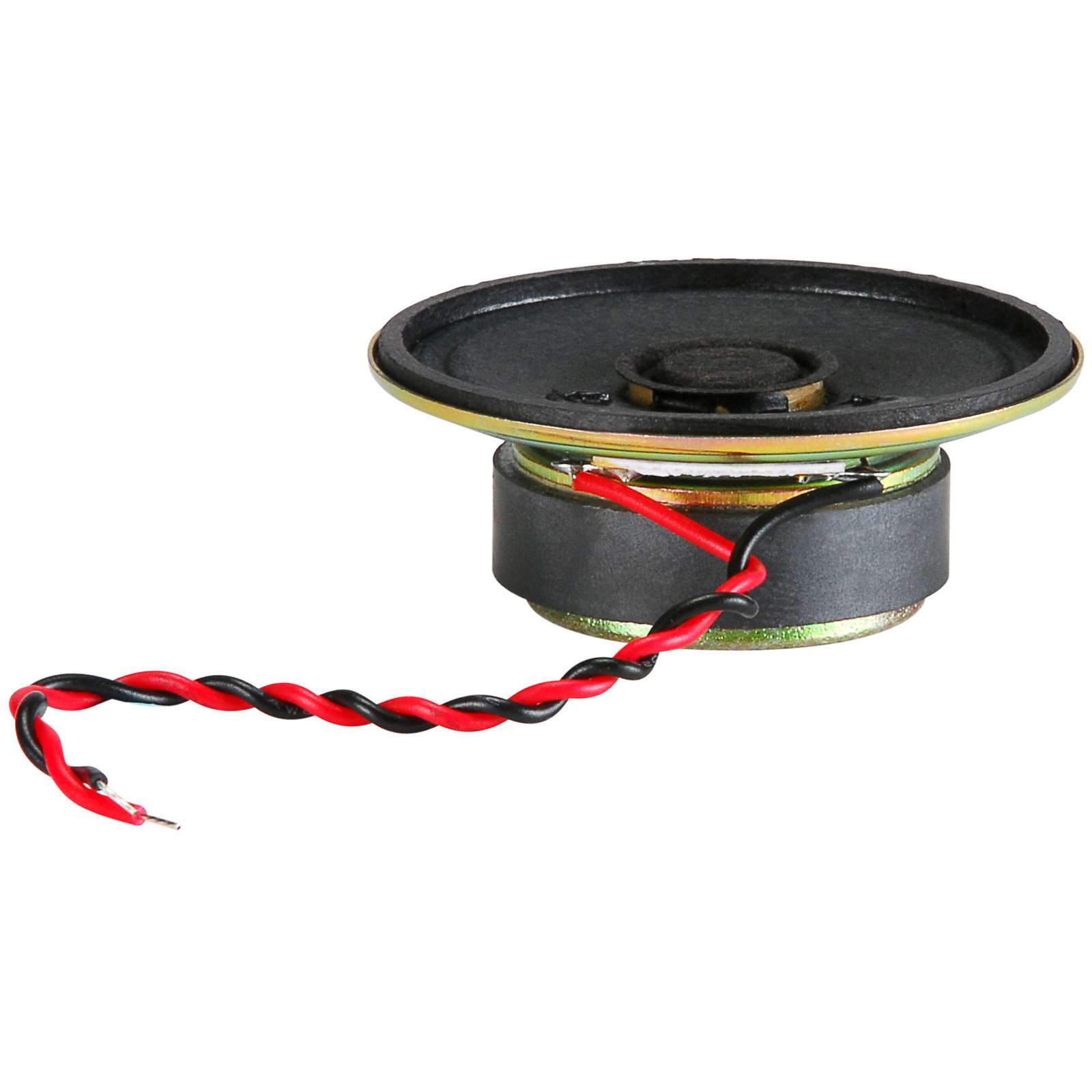

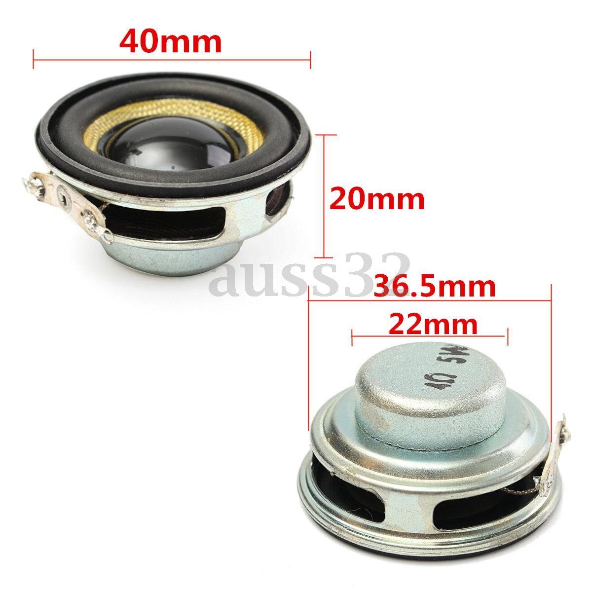

That's the reason I asked dunno. It's for a DIY of a 1.5 Range speaker(Ordered from ebay 3 weeks ago) that I want to solder. Just don't want to spend too much. I'm sure I can get them from China for a reasonable price on ebay. I'm thinking they are 24 gauge although not sure. My 16 gauge cables are too thick for this project. These are my drivers:
What is too thick about your 16g to work? Do you need two colors to keep things straight? You just need a few inches of each? Maybe just go to a car stereo installer and see what they have?
