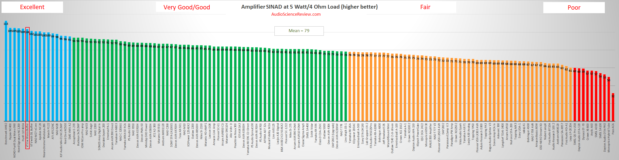

Since you mentioned "best" and then "low Distortion levels and close to Neutral as much as possible" I assume you want something with distortion level plus noise below 0.005%. If that's the case, look to the Hypex or Purifi based amps. Two 6 channel amps should be good, better than one single 11 channel amp imo.
No Emotiva amps I know of that could compare to those Hypex or Purifi amps.
Take a look of those measured by ASR, I don't recalled any Emotiva amp measured with THD+N better than the mid range Denon and Marantz AVRs let alone power amps.
