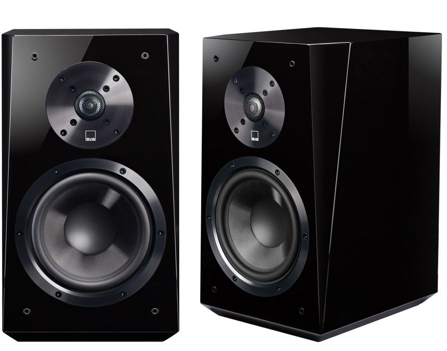

Well I don't know where you've been seeing negative comments about SVS speakers! At least the Ultras. I had the towers and books. They're very good speakers, great for music or home theater. I'd daresay I suspect the Ultra books sound better than the Q150, and by a pretty good margin. I haven't heard the Q150 tho, so that's not for certain, but I can get a pair of them for 80 bucks on Craigslist right now.
What I did was kept an eye on SVS' outlet and waited for some Ultra bookshelf speakers to pop up for $399 each. It's their open box/scratch n dent section, but they're all inspected and come with the full warranty and trade up deal. They include images of any blemishes so you can see what you're getting. Some are so minor they're pretty much invisible. So there's that. Lots of other companies out there to choose from tho. If your budget is really tight I've been finding some really good deals on Craigslist out here in the Phoenix area.
I agree with everyone saying to put some more budget into at least your front 2 speakers, whether you give SVS a shot or another brand. It's best to have at minimum your front 3 speakers matched by brand (timbre) for a seamless blend. You can skimp a little on your surround speakers because they don't see as much action and are pretty much just for effects. To use SVS as an example, I would get Ultra speakers for my front 3 and Prime for my surrounds. I'd just start with the front 2 and buy the rest as funds become available. Nothing else on your list of gear will have more impact than your 2 main speakers for music.
